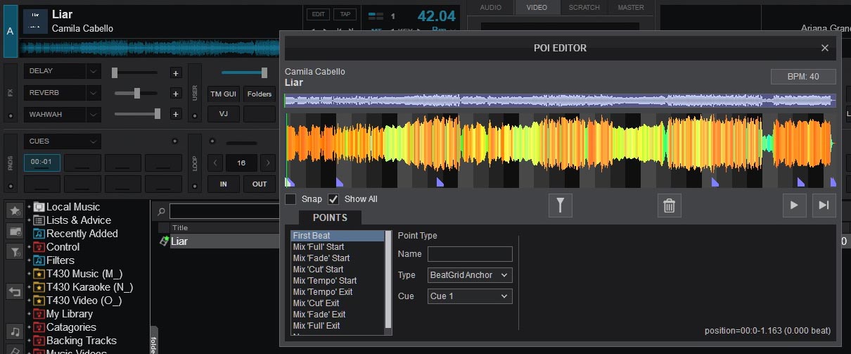

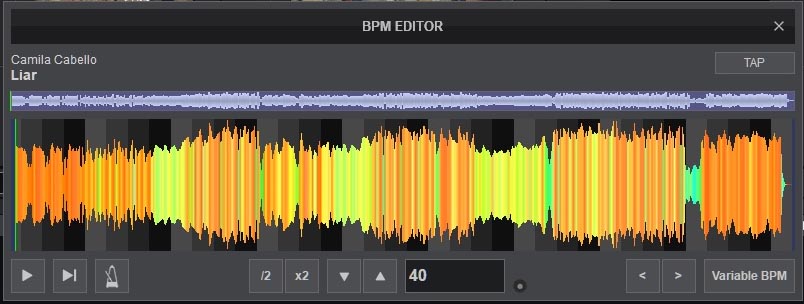

Hi
Since there has been no reply and a whole new version of VirtualDJ is now out, I tracked down the original backup of one of the files I had problems with, and the issue is still present. It must be something to do with the file itself, but I don't know what, anyway here are some screenshots.
This is the BPM Editor for the file, the anchor is not visible, I can not view it by dragging the waveform left or right, the view you see is maximum zoomed out.
I then went to the POI editor, and selected "Firstbeat" and changed it to "Cue 1", with cues set to display the time of the cue, you can see that the cue is set to 00:-01, this part of the waveform is not displayed, you cannot drag the waveform to see this position.
I have this file unaltered and not working if anyone from Atomix wants to inspect it to find out the problem. The couple of files I have had this problem with are from professional DJ services.

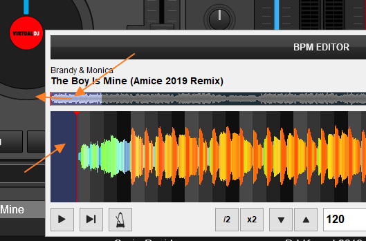

djkrysr wrote :
Try using BPM Editor pictured here :-)
Posted Wed 30 Jun 21 @ 11:44 am
