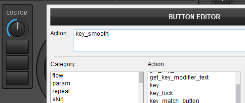

Use the 2-Decks default skin. From the top LAYOUT menu, enable "Show some empty buttons"
Then right-click on the knob that will appear next to the jogwheels and assign as .. key_smooth

Thanks, is there anyway to change the range of this knob? It's currently -6 to +6, it would be nicer as +2 to -2, maybe even using the buttons to smoothly change the key up or down a semitone over a half a second period?

For an endless encoder on a controller, the range could be adjusted, but with the skin knobs, havent found a way.
"Smooth" Buttons can be ..
key_smooth +0.02
key_smooth -0.02
Change the 0.02 to other value for less/greater accuracy

for a range of -2 to +2, I've ended up with this for the knob: param_add 1.43 & param_multiply 26% & key_smooth

Buttons work here. Make sure you copy/paste the above action. You use Custom buttons for them, not the custom knob, right ?
for the knob, this one works for me..
param_add -0.5 & param_multiply 0.26 & param_add 0.5 & key_smooth

Nah the buttons straight up don't have any effect when using "key_smooth +0.02" pressing the button repeatedly or holding still has no effect.
Thanks for that for the knob - could you explain exactly how what you've put in the script works? Does subtracting the adding back the 0.5 after multiplication centre the original key of the track directly upward on the knob?

And seemingly at random - testing out the buttons again. It's somewhat started working. How bizarre. The units of "key_smooth" escape me though. Using "key_smooth +0.5":
First press: Key +1
Second press: Key +2
Third press: Key +4
Using "key_smooth +1.0" always sets the key to +6 - is this just bugged

You might be seeing a rounding error with respect to the key displayed, if say you're bang on Cm and you key smooth +0.8 semitones you're neither on Cm nor C#m but it has to show something so it rounds to the nearest whole semi-tone [there's an argument to actually use a decimalised key scale for accurate reporting, since we can. But that maybe too forward thinking for most, we've used the whole semitone scale for hundreds of years and the "we've always done it that way" attitude is hard to change]
I figured this out a few years back [documented here
Key Smooth (from -1 to +1) (dial)
param_multiply 0.16 & param_add 0.44 & key_smooth
I can't remember exactly the maths and it might not even be bang on but as I said key is rounded so it's up to your ears and a bit of extended range is no bother.
I think for scaling a dial to be centred on 0 it's
1 - scaling factor = correction, multiply the dial by the scaling factor and then add the correction.

Yep, it's pretty simple, key_smooth works with zero as it's reference, vdj script can increment your value. Give me a day and I'll bodge a script that will give the results you want with a button.

Ok for clarity; you don't want to move key "while_pressed" [completely manual] you want to press a button and move up/down a key over a predefined duration, what duration?

let's say the duration should be half a second, or a beat if that makes it easier. Also I've not heard of the pitch addon - I'll see what I can find out about it now.

repeat_start_instant 'rsiKeySmooth' 50ms 10 & key_smooth +0.008333333
or
repeat 50ms & key_smooth +0.008333333
for clarity key_smooth is -1.0 to 1.0 which translates to -6 to +6 key therefore your script key_smooth +1.0 would always result in +6 key

Thank you greatly for all your help, can I ask what the "rsiKeySmooth" refers to? trying to get my head around the scripting.
