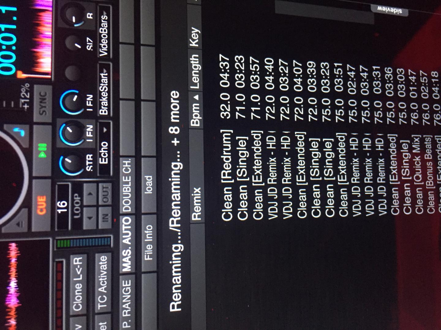

The last few weeks it seems like every time I open VDJ it starts renaming, WHY??
Why is it doing this?? Did I change a setting I shouldn’t??
My last gig I could tell my Mac was taking a hit because of it.

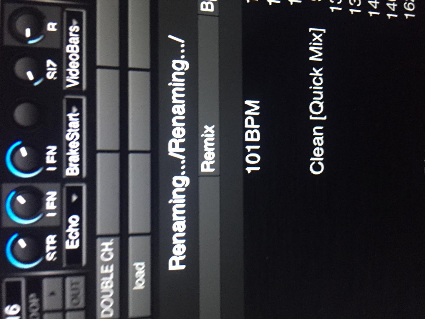

Just fired VDJ up and it just starts doing this
Why is this happening??

There's probably a playlist with a file that has been moved.
In case it takes too long you can check the tooltip to get more info

Ok so I had to finish out my night, it never went anyway.
But after checking the tooltip it said “Everything 0%”
So I started going through all my playlists and I do not have a list by that name.
I searched my Mac for it and nothing comes up.
So I went and moved all my playlist and I’ll enter them back in one by one until I figure out what is going on.
It’s almost 3am and I’ve had a long day, I’ll wake up tomorrow and check everything out again and report back.
Posted Sun 28 Jul 19 @ 7:52 am

That was it!!
Had an old filter folder buried deep within some other folders.
I deleted the folder and its no longer renaming.
Thanks for the time and info!!
