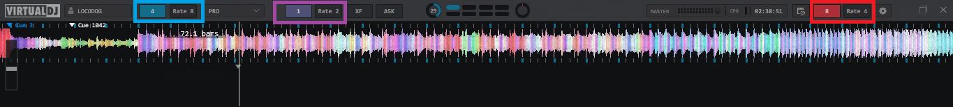

I added some custom buttons as a visual for when I finally get my launchpad remapped and stop using the vdj pads
purple is master, blue left, red right [left and right are for my singleVideoControl padpage, it's in the review stage]
