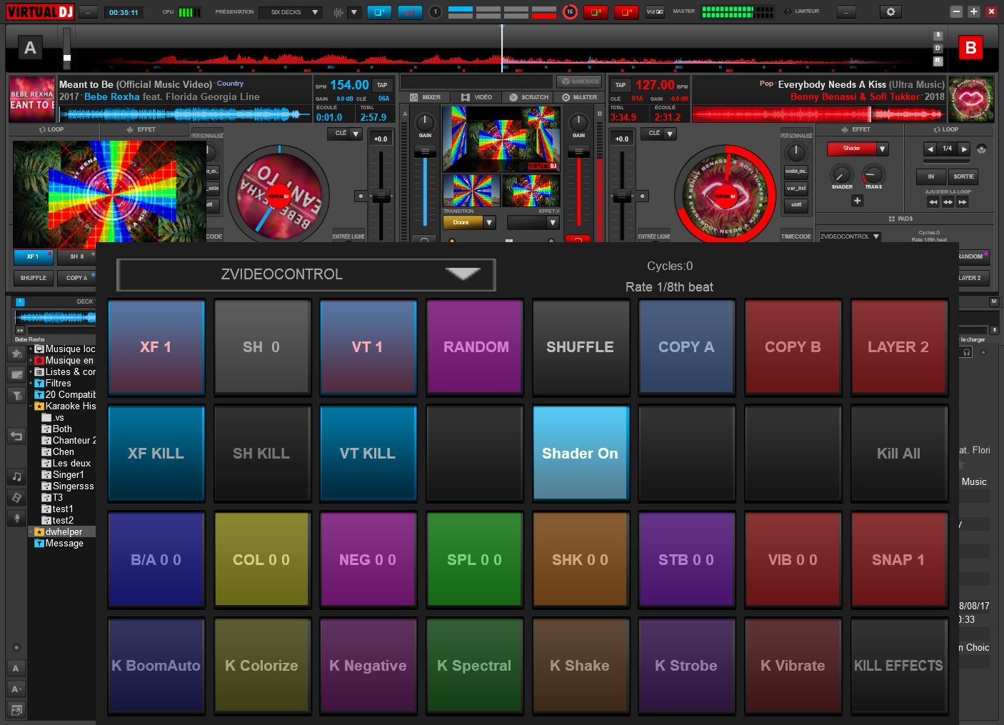

Discussion about ZvideoControl
ZvideoControl is a combination of my 2 previous video pages (autoVXF and autoVFX)
rolled into one page and this has some minor improvements (now uses beat_bar and the rsi runs at 32ms so things are much smoother), and one massive improvement that it doesn't need the builder addon (therefore it's mac friendly)
This padpage is mostly focused on deck master [controls the video crossfader, the video transition, the master video fx] Although it does control [change] shaders on decks too.
Why "ZvideoControl" as a name, well 2 reasons, Z is the last [indicating master, but masterVideoControl or finalVideoControl sounded cheesy] the other reason is starting the page name with "Z" makes it super quick to select for keyboard users [can't forget my keyboard only roots]
*UPDATED to v1.2 2020/01/23*
pad 1 is auto video crossfade [fastest is full left to full right to full left in one beat] [padshift stops]
pad 2 is auto shader swap [shaders on decks] [fastest is change shaders every 1 beat] [padshift stops]
pad 3 is auto transition change [fastest is every beat] [padshift stops]
[The above 3 buttons if the current rate is the same as when the action was started a second press will also act as a stop]
pad 4 makes the transition pick at random [padshift 4 picks 'random' shaders when shaders swap.]
pad 5 shuffles the shaders on decks once [padshift 5 turns shaders on or off decks 1 & 2]
pad 6 copies shader b to deck a [padshift 6 pauses shader swaps on deck a]
pad 7 copies shader a to deck b [padshift 7 pauses shader swaps on deck b]
pad 8 opens up the second layer [double tap to get back to first layer] [padshift 8 kills video crossfader, shader swap and transition swap all together at once]
param 2 changes the rate of the auto buttons [pads 1,2,3]
layer 2 does master video fx
param 1 changes the repeat count [1-512 repeats, if you select 0 the count will go upto 1024]
param 2 changes the rate [1/8th - 32 beats] [exactly like layer 1]
Of course layer 2 uses pads 9-16 [I could have used a software shift but didn't, I'll include a remaping guide soon]
pad 9 does master video fx boom auto [padshift kills]
pad 10 does master video fx colorize [padshift kills]
pad 11 does master video fx negative [padshift kills]
pad 12 does master video fx spectral [padshift kills]
pad 13 does master video fx shake [padshift kills]
pad 14 does master video fx strobe [padshift kills]
pad 15 does master video fx vibrate [padshift kills] [x64 users when we get more video fx, I'll update]
pad 16 does snap, it will sync the fx called [after snap is on] to the down beat of the 32, [padshift kills all master video fx]
update v1.2.
Added padshift 6&7; pauses shader swap for decks A & B respectively.
Changed how pads 1,2,3 work; before button queried rate and then setup a rsi, now button starts a rsi that then queries rate. This allows changing rates for these buttons with just 1 variable [each button] [much nicer than the wall of script needed before]
video crossfader "set '$xBar' X"
shader swap "set '$sBar' X"
transition swap "set '$tBar' X"
values allowed 0,1,2,4,8,16,32 [0 = pause, stationary, no change]
Changed 'snap'; previous sync'd to the 1 of the 4, now sync's to 1 of 32.
Fix bug; previous build snap didn't sync when action was already running.

Tryed it while testing simultaneously
- a big 32 button pad page on a touch screen
- with multiple video windows skin
- a video skin with video insert
result is really impressive !!

Hey thanx for your responding :-)
I found out how to change rate on the SH, VT and XF.. to be honest.. this was rendered when capturing my only 1 screen, so couldn't acces any setting.. XD ! But this result was awesome already :)
Some weird thing.. Yesterday, when I first installed the add-on I was able to acces layer2 (and layer1) by 2 small buttons but later that evening it was gone.. and even layer2 isn't accesable now (??) Though they can be activated by midi there's no way to turn the fx off now.
Today I found out my first added midi controller (launchpad mini) makes layer 2 accecable again by plug-in it in again.. Weird huh??
Anyway.. looking forward for your work and a sort of toggle function on the SH , VT and XF setting. (Y) I need to figure out how which script is used for the shift key.. any suggestions on a lauchpad?? shift or shiftpad isn't working..
oh.. and how do you turn the (fx) buttons off now?? By disabling them manually with a mouse? Or is there another way to turn the fx off?

locodogPRO InfinityModeratorMember since 2013
the second layer might be setting>sixteenPadsMode [switch to on]
fx off [say B/A, boomAuto] is deck X padshift 9 [X being the deck number,that's the script]. or all fx off deck X padshift 16
launchpads are pretty freeform for mapping, and the native mapping is pretty sparse, I'd use something like below
[should be enough to get you going]
Y8 mapped to
shift
Y3 mapped as
set '$padmode' 3
Y3 LED
var '$padmode' 3 ? get_constant '#00FF00' : off
'$padmode' 3 would be my 'pads' variation
then for 1.1 I'd do something like this
var '$padmode' 0 ? var '$recmode' 1 ? sampler_rec 1 : sampler_pad 1 & sampler 1 select : var '$padmode' 1 ? deck left hot_cue 1 : var '$padmode' 3 ? shift ? deck 1 padshift 1 : deck 1 pad 1 : nothing
and 1.1 LED
var '$padmode' 0 ? get_sample_color 1 : var '$padmode' 1 ? deck left hot_cue 1 ? get_constant 'red' : get_constant '#550000' : var '$padmode' 3 ? shift ? deck 1 padshift_button_color 1 : deck 1 pad_button_color 1 : nothing
for layout I'd use 1.1 to 1.4 for deck 1 pads 1 to 4, I'd use 1.5 to 1.8 for deck 2 pads 1 to 4
and the next line down do similar but for pads 5 to 8 & next line 9-12, and so on...
I'd also change up, x buttons to give you access to pad param & param2 [gives access to count & rate for this padpage]
X1
var '$padmode' 0 ? sampler_volume +5% : var '$padmode' 1 ? deck left slicer 'length' -1 & deck right slicer 'length' -1 : var '$padmode' 3 ? deck 1 pad_param -1 : nothing
X2
var '$padmode' 0 ? sampler_volume -5% : var '$padmode' 1 ? deck left slicer 'length' +1 & deck right slicer 'length' +1 : var '$padmode' 3 ? deck 1 pad_param +1 : nothing
X3
var '$padmode' 0 ? sampler_bank -1 : var '$padmode' 1 ? deck left slicer 'step' -1 & deck right slicer 'step' -1 : var '$padmode' 3 ? deck 1 pad_param2 -1 : nothing
X4
var '$padmode' 0 ? sampler_bank +1 : var '$padmode' 1 ? deck left slicer 'step' +1 & deck right slicer 'step' +1 : var '$padmode' 3 ? deck 1 pad_param2 +1 : nothing
that should get you started if you need more help open a thread about that.
And once you get to grips with it drop a video or two here
http://www.virtualdj.com/forums/229880/Video_Discussion/Show_me_some_your_video_work__please.html
Posted Mon 06 Jan 20 @ 1:54 pm
Wow man!! Thanx!! really awesome :-) Though this was really hard to get my head around I got all 16 pads working on layer 3. (it took a while to figure out which parameters I had to be change for the different pads).
Don't know if I undstood what you mean by "Deck 2". That's the pad deck right? and not players ;-)
btw.. Is it correctly the pad 'shake' and 'shuffle' doens't have any visual led responce? Shuffle shows no led while I press, and isn't really needed.. but 'shake' isn't blinking while the other effects do blink.. it does show a led while pressed..
Anyway.. by using a midicontroler now the shift button really comes in handy.. in fact you can turn off everything independently, and that's perfect. Oh.. and also the 4 Y buttons are super handy :-)
I'm really surprised with all that is possible.. I will do a video (or two) for sure.. but first I have to get used to all that's new :-) And Im thinking about mapping the shaders.. and make those selectable on the computerkeyboard.. I sooner red this is also possible by script.. but need to make it work for myself that's tough puzzle sometimes..
Posted Tue 07 Jan 20 @ 1:05 pm
Good good. A little struggle makes it an accomplishment. Remapping is all about making your HW yours.
Correct, shuffle has no light, as you say it doesn't need one and the blank pad is a visual reminder/check what pad I have on my launchpad [mk2] or my Neons.
Shake however should blink [orange], it looks ok my end but I'm looking at a version yet to go public, wait to see if the release sorts it out. previous version might have had a typo, maybe you have a typo, possibly your LPmini can't do "orange" [which LPmini is it, 1,2 or 3?] Will look again after the new release.
You'll find scripts for all things shader here [post with the video]
http://www.virtualdj.com/forums/223743/General_Discussion/Script_School.html?page=3
Posted Tue 07 Jan 20 @ 2:38 pm
