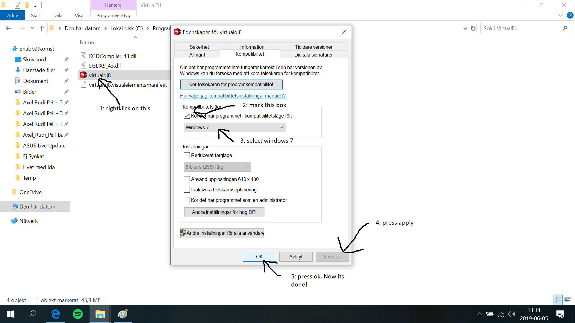

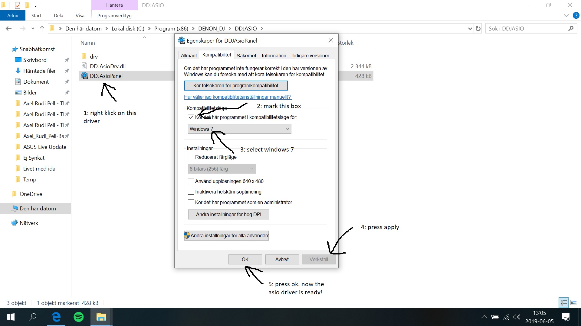

I am having the same issue. As soon as I connect the Denon ASIO as the music output VDJ just shutsdown.
I found a way to avoid the problem in my system with windows 10 64 bit!
You have to put the Denon ASIO driver and the VDJ program in compatibility mode for windows 7.
Follow this steps below:
Step 1:
Step 2:
Now VDJ works perfect in Denon ASIO Mode.
Have a nice day
Best regards
Erik Backman

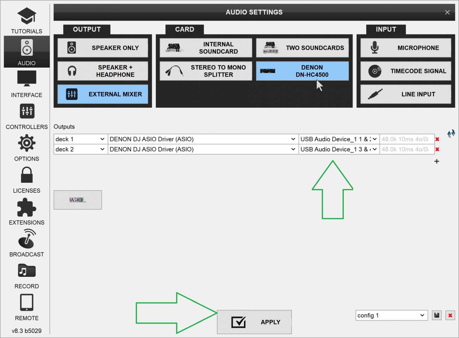

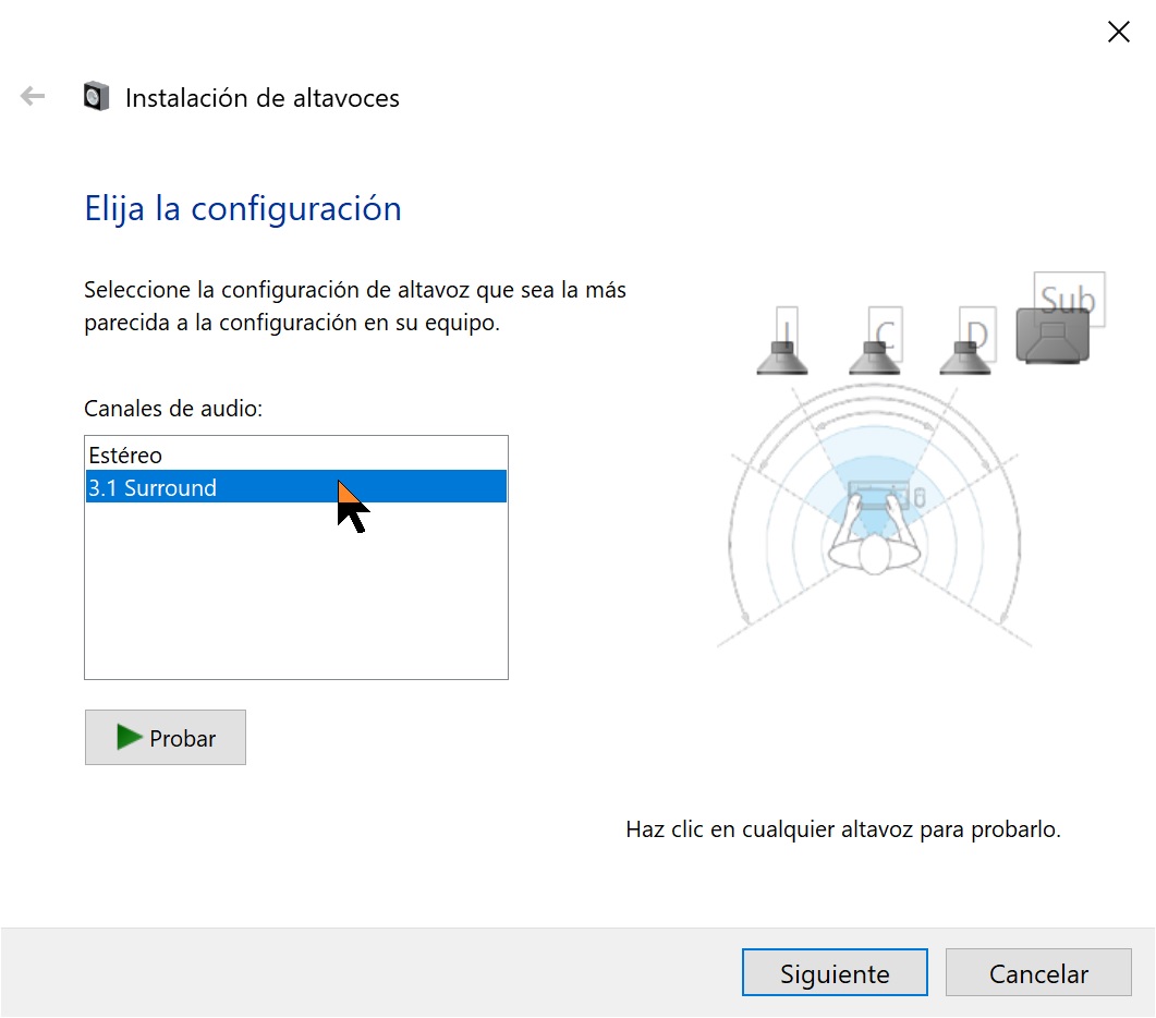

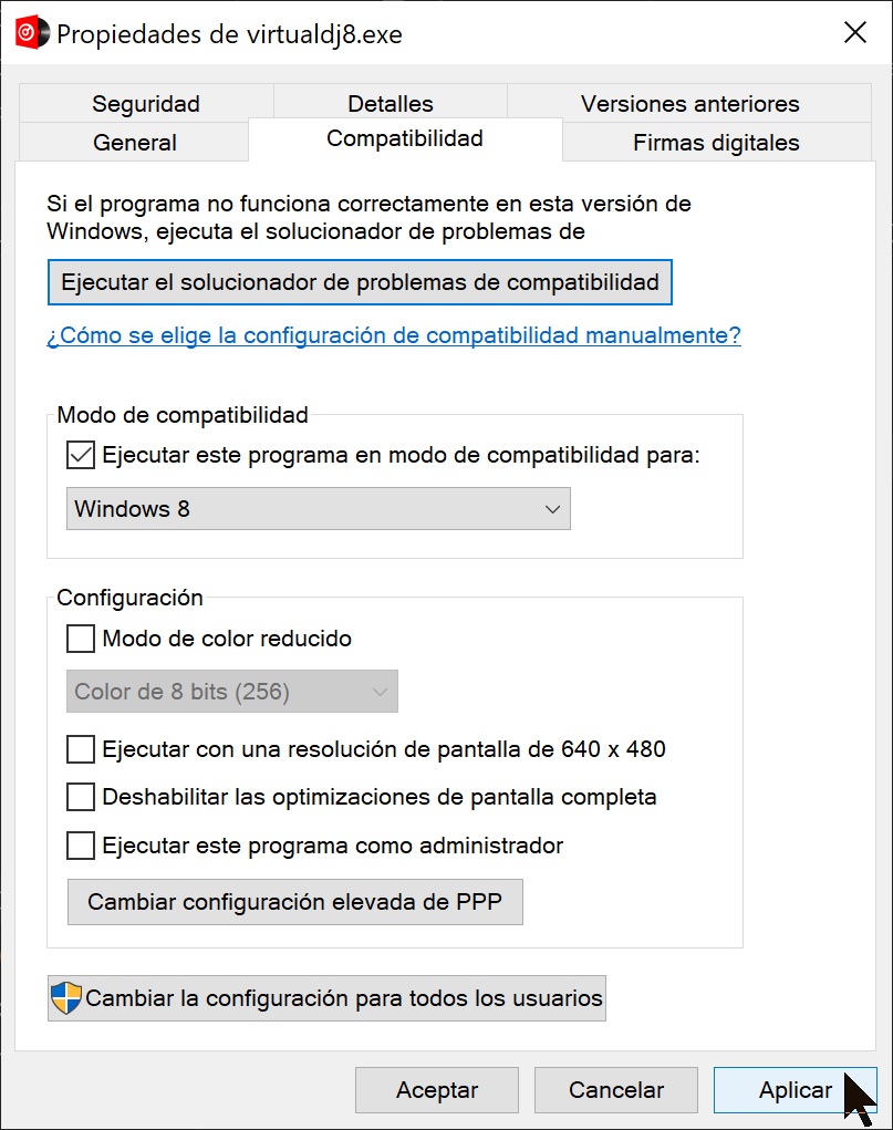

I like to add some notes:
VirtualDJ 2018 32 & 64 bit works fine with the HC4500 in WASAPI mode up to 96KHz sample rate but in 16 bits only. HC-4500 can work in Stereo in 24 bits and Windows 10 set to be used this way and fails to open 4 channels in VirtualDJ as needed, so need to be set manually at 44.1, 48 or 96 KHz sample rate but in 16 bit in Windows Audio setup (Windows Panel Control --- Hardware --- Sound --- Playback Devices) this because a HC4500 limitation in its configuration.
Then in Speaker Configuration, set it to work in 3.1 with full range speakers:
Denon ASIO 2.2.2 works perfect for any old Denon product (S3700, S1200, HC4500, MC6000, MC3000, etc) and works fine in VirtualDJ 32 bits only. VirtualDJ 64 bit need 64 bit drivers and some old Denon products may not had a 64 bit driver (like hc4500) and other may not work good (like MC6000 2015 Asio drivers). WASAPI setup works fine for all Denon products, so it could be use safety and in VirtualDJ 64 bit is the only way to make work HC4500.
If you plan to use Denon Asio 2.2.x with HC4500 just need to setup VirtualDJ8.exe with compatibility mode for Windows 8 or 7. ASIO Denon panel does not need to be changed.
This problem is already under testing to get a solution in a future VirtualDJ build, Devs are working on this. So the workaround is a temporary solution.
