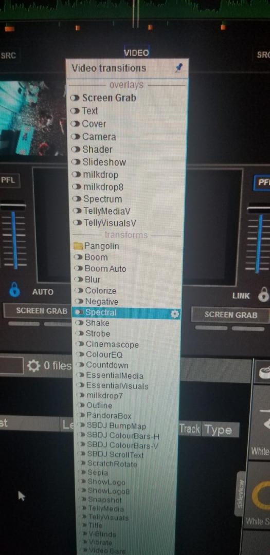

I already check my setting xml, and this is what show: videoTransition>Screen Grab</videoTransition>
How do you change this?
Posted Sat 11 May 19 @ 3:25 am
Close vdj, remove that line from settings.xml, then restart vdj
Posted Sat 11 May 19 @ 3:51 am
This is what show on my screen
Wherever I do, won't change
Show Screen grap on both side
I open Virtual DJ 7, no problem
Posted Sat 11 May 19 @ 4:18 am

Adion wrote :
you removed screen grab from settings.xml ?
I don't know how to do it?
Posted Sat 11 May 19 @ 5:24 am
setting xml, videoTransition>Screen Grab</videoTransition>
Close vdj, remove that line from settings.xml, save, then restart vdj
failing that try the same with videoAudioOnlyVisualisation, just a punt
Posted Sat 11 May 19 @ 5:46 am
