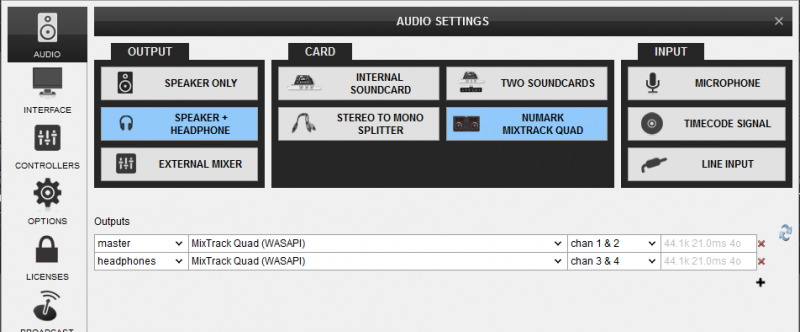

Hello all. I need some help with the following. The onboard listening player in the software, where to i go in settings to route that music to my headphones only? Currently, when i select clips to hear, it plays them in my live mix which is a complete no no. I have been sending messages back and forth in the ticket area but they just can't seem to get to the point and help me. I send them pics but they do not get them so i am at a loss here. Any help would be appreciated.Please find the current settings of my audio. Thank you.

Just make sure there's a headphones output in your audio setup and it will go there

Here is my present audio output settings. i hope you can see the image...i'm new here. thx.

I suppose it was not connected while you took the screenshot then?
Anyway, the headphone works otherwise for pre-listening the decks?

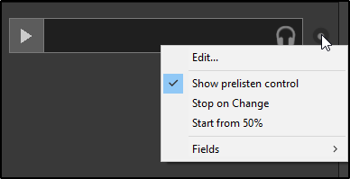

In PachN Link of the Manual Numark Mixtrack Quad found this:
The unit has a pre-defined Audio setup and a special button in the AUDIO tab of Config to provide that. Alternative Audio setups can be applied in the same window
Eventually you must config the Pre Listen Player to Automatic to root this on the Decks.
In default he is on Headphone out.
https://www.virtualdj.com/manuals/virtualdj/interface/browser/fileinfo.html

Where do i go to configure the prelisten player to automatic on the decks? I am so confused with this? I cannot change any options from the software when i select "info options" it does not give me any options to change the prelisten player to any specific deck. I know it has to do with my audio config setup or maybe its something else. I tried again today and during my mix all the tracks i listened to in the prelisten player plays in my live mix as soon as i press play in the software icon. I am using Streamlabs OBS as my client to stream my mixes. Any suggestions would help. Thanks

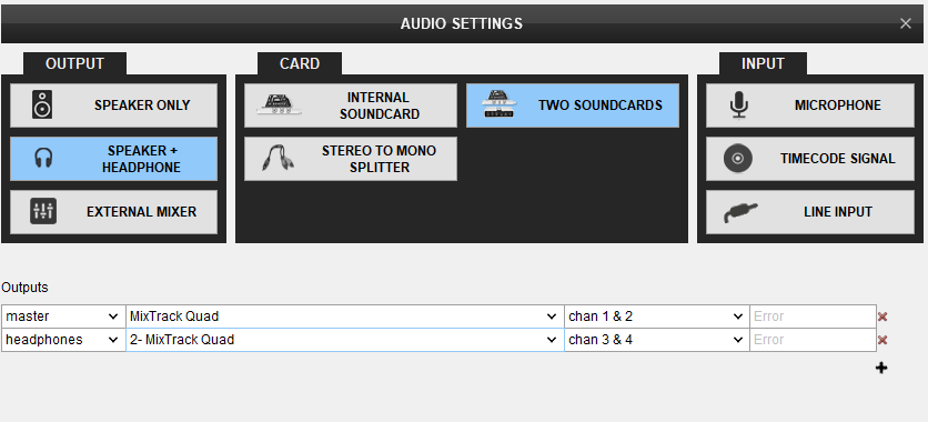

What does your audio setup look like?
The small Dot (Point) they should therefore the Option For Prelisting Player.
