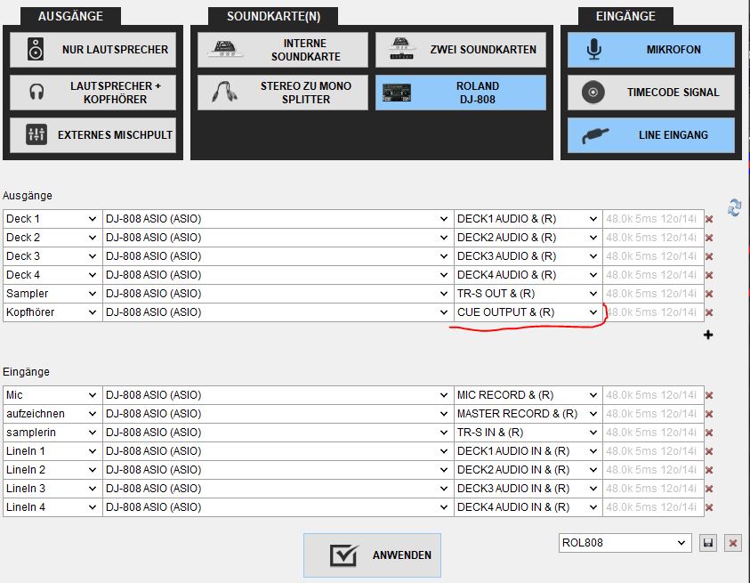

When you say that you use the Booth Output, you just connect speakers to the Booth Output socket of the DJ-808, you dont add a Booth line to the VDJ Audio Setup, right ?
Your Audio setup is as shown here ?
http://www.virtualdj.com/manuals/hardware/roland/dj808/setup.html

Ok ... I'll try again.
At home I use the BOOTH-OUT for the sound output to the small monitor boxes. So I can use VDJ with the controller without any problems and all the buttons etc. as well as my mapping work flawlessly and without any problems ..... also 8 hours at a time: - ).
Now I had a DJ job in a disco on a Saturday night and did not use the BOOTH-OUT but the MASTER-OUT as a sound output and then I had this failure of the Roland R808, sound is suddenly gone when I pressed one of the CUE-PADS and also the SyncButtons gave wrong values if for example on Deck 2 124BPM were displayed and I then wanted to adjust the track on Deck 1 via Symc button I got on Deck1 either 80 BPM displayed or sometimes 163 BPM.
I then followed everything at home again. With several reboots of the controller and VDJ I could then determine the following:
Restart with sound output on BOOTH-OUT always OK.
Restart with sound output on MASTER-OUT first everything OK and then with a second restart came then again these errors with the Sync. I then several times the driver completely deleted from the system W10 - also cleaned the registry - and everything on NEW - as when the controller is connected for the first time - reset and then restarted.The driver was loaded directly from the Internet and also installed correctly, at the start of the controller were also the cables to BOOTH-OUT or MASTER-OUT connected, and the amplifier to the speakers turned on and each time it came back to the errors when the sound should go to MASTER-OUT - with BOOTH-OUT this was never the case there everything was always OK.
The service of the company Roland wrote me now that it would probably hang with the VDJ software and the controller actually runs only with Serato perfectly.
Screenshot from my Settings

As for your audio issue, one thing i would also try would be to set the computer's built-in sound card as default for the OS instead of the Roland DJ-808.
When a USB sound card is connected to a computer, Windows will select that as the default sound card, and this may cause some hickups at some point (some ASIO drivers require exclusive use of their WASAPI to work properly). So with the DJ-808 connected, open windows Sound panel, see if the DJ-808 is selected as default playback/recording device and change so that its using the Built in instead.
