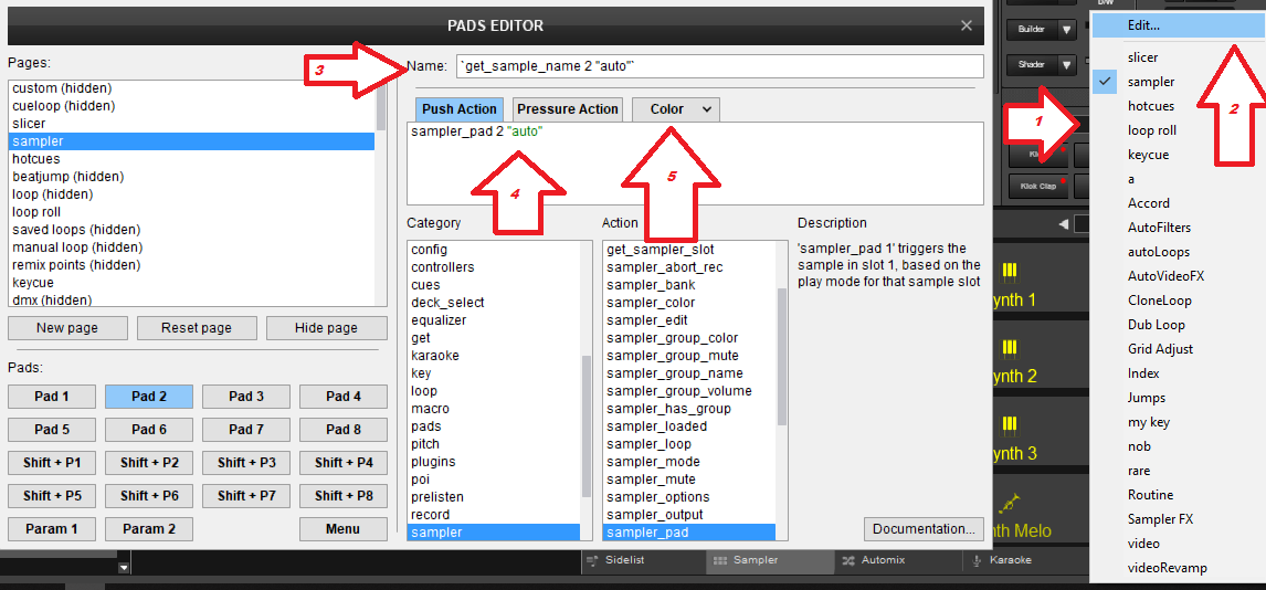

Ditch the "auto" from the script, the pad name textbox & the colour
I know where the script is and how to find it, but not sure what you mean? Should I delete just the words "auto"?
no where in Setting/Controllers/Pioneer DDJ-SX2 when I select SAMPLER_PAD1 does it even give me script to edit. Am I looking in the wrong place?

Not the controller mapper, inside the pad editor
Awesome there is one. Where do I access it? lol. Sorry

ok, thanks. found editor. I then removed auto. didnt reassign the simple kick to pad 1 though.

locodog wrote :
you did all 8 pads?
No I didnt Loco. Im not accustomed to messing with the scripts at all. To clarify what Im supposed to do. I should click through the Pads on the left 1-8 and remove the word "Auto" from all 8 on the Name, Push Action and Color Tab....is that correct?

yep that's it.
I'll fill you in with what "auto" does.
If a sample pad higher than 8 has anything on it then deck 1 pads does sample pads 1-8 deck 2 pads does 9-16
If the sample pad has nothing on pads greater than 8 then deck 1 controls 1-8 and deck 2 also controls 1-8.

There is that.....or rather than using the default 'instruments' bank, make a new one and just put the sample you need on the pad you want.

True but if the bank is bigger than 8 then the problem will still be there.
