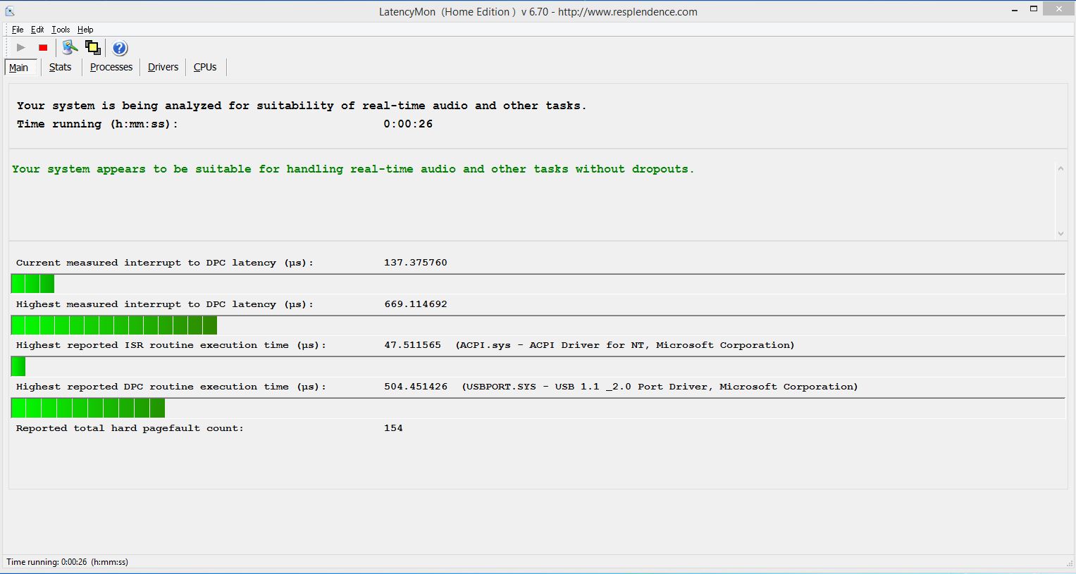

Posted Mon 14 Jan 19 @ 11:54 am
Here are the results from my nearly 5 year old DJ machine whilst VDJ is playing using the MCX8000 and Denon ASIO drivers.
If your results don't look like this then you definitely have issues.
