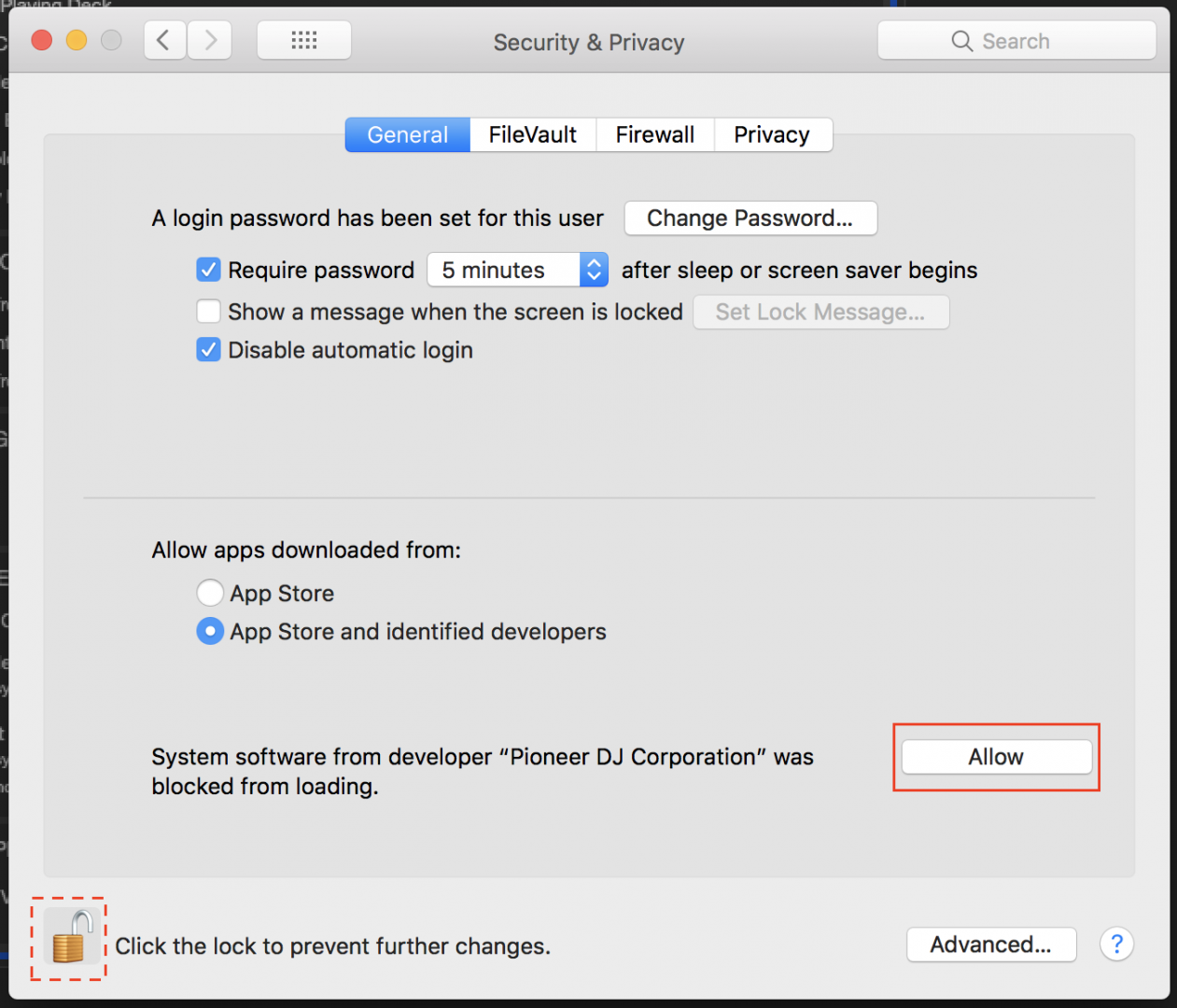

As your a Mac user on Catalina - I assume you approved the drivers in System Preferences after installing them?
Image shows Pioneer but it will be the same for Reloop
Posted Fri 17 Jul 20 @ 11:57 am
