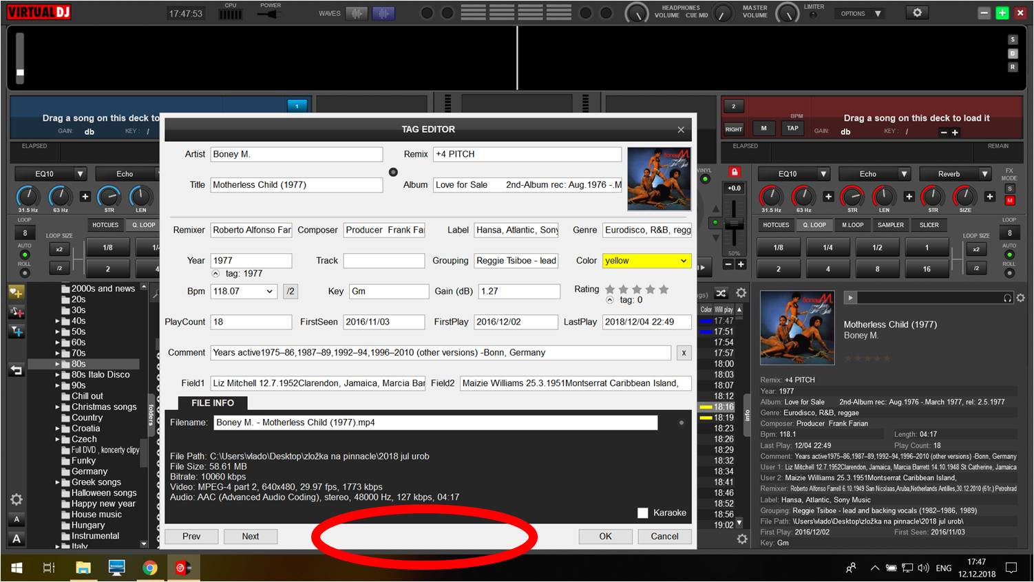

Friends please why I have not there the button " WRITE TAG " ??? :) Here is a Picture....
Posted Wed 12 Dec 18 @ 5:04 pm
AdionPRO InfinityCTOMember since 2006
Probably you have setTagsAuto enabled, so tags are written automatically when you press OK.
Posted Wed 12 Dec 18 @ 5:08 pm
OK thank you it is working... :) now I have there this button hallelujaaaaa :)))))
Posted Wed 12 Dec 18 @ 5:36 pm
from the support team on my tickets the guy wrote to me that for all manual changes in TAG I have to click to " WRITE TAG"....
but if I have enable autoset TAG -- it is not working automatically? and then save to database is different????
Posted Wed 12 Dec 18 @ 5:59 pm
Changes are saved to the database automatically. The updating of the tag is optional depending on the setting for setTagsAuto. If set to no then the button appears so you can update a tag manually if required.
