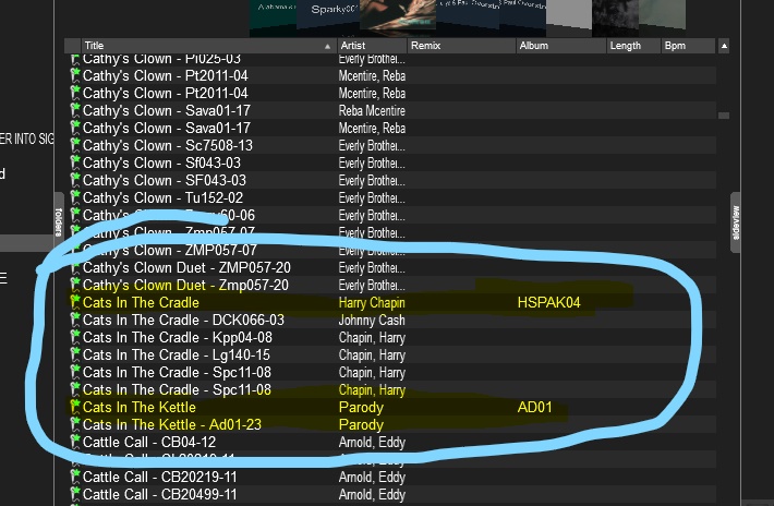

I know I cannot be the first one to ask this, but I cannot find the answer. I have been searching for a couple of days and have finally given up finding the answer on my own. This is a two-part question. Please feel free to direct me to the proper video tutorial or correctly answered post.
1) Tagging music on my hard drive: I painstakingly spent days (using Bulk Rename Utility) tagging 450K karaoke files. They are all the exact same. Right or wrong - they are all tagged in the same manner (artist - title - album #). However, in VDJ they are all over the place. I knew I may have missed a few. But no, I have checked and double checked. The ones in my sample pic are identically entered on the hard drive. The highlighted selections are how it should look.
Whether I tagged them correctly or not - they should all be the same in VDJ. They are all tagged the same - right or wrong. What am I missing?
I’ve tried the “Reload Tag” option. Nothing changed.
2) Write Tag: How does this work? When checked, does this fix the filename on my hard drive? When I use Write Tag, I see no difference on my hard drive tag. I think I am misunderstanding what this function does.

Best is to check what the difference is between the 2 entries using the tag editor
As said perhaps one of them has info stored in the tag, and the other doesn't?

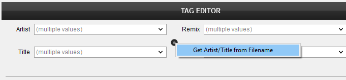

My 2 cent tip if you have just renamed the files (not updated the ID tags in the file itself) you can bulk tag them in VDJ by:
- selecting the files you want to update in the VDJ file-list pane
- right-click on that selection and choose "Tag editor". There will be "(multiple values)" in the fields in the new dialog - just leave them as-is.
- Click the tiny button in the upper pane and select "Get Artist/Title from filename" (see image below).
- Now hit "Write tag" at the bottom of the dialog to insert ID3v2 tag for mp3 files, or just OK to update just the VDJ database.

Did that - absolutely no difference. They look the same inside the tag editor. That's why I'm so confused.

tryingcake wrote :
Could you show a screenshot of both files in tag editor?

The Get Artist/Title from filename option shown in the screenshot above doesn't work either for you?

Ah, CDG, or CD+G files doesn't support tag information themselves, and is probably why the Write tag button is hidden. CDGs used to live on read-only CD Audio ROMs (which the (G)raphics hidden away in a separate section). The data can still be stored in VDJ's own database.

It should work with multiple files selected as well
Posted Thu 06 Dec 18 @ 7:40 am
If the write tag button is hidden it's probably because setTagsAuto is set, which will make writing tags automatic on pressing ok.
For zipped cdg+mp3 vdj will not be able to write the tag though, but anyway your changes are still saved in the vdj database
