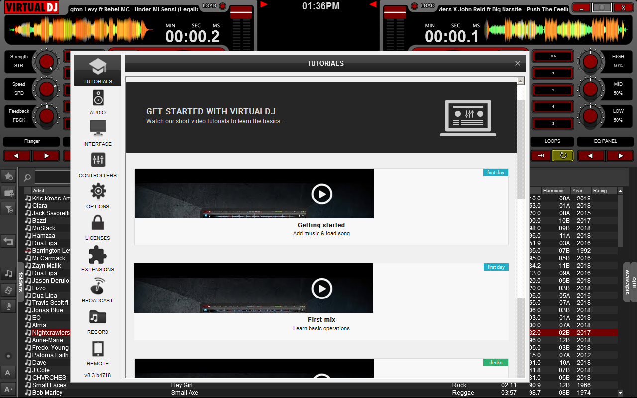

Confirmed. It runs, and tracks play (that's the main thing!) but the tutorials config screen is messed up.
Rather than showing lots of small video previews in boxes with text descriptions, the videos are massive and only show the top section, plus there's no scroll bar on the right side. Res is 1280 x 800 on a 15.6" screen.

I don't think Microsoft will fix Internet Explorer on Windows XP, so not much we can do about that :p

How / why is IE involved?
Posted Sat 08 Dec 18 @ 2:17 pm
The tutorial tab is just a webpage, rendered by the native WebView component that uses the IE render engine for showing web pages.
