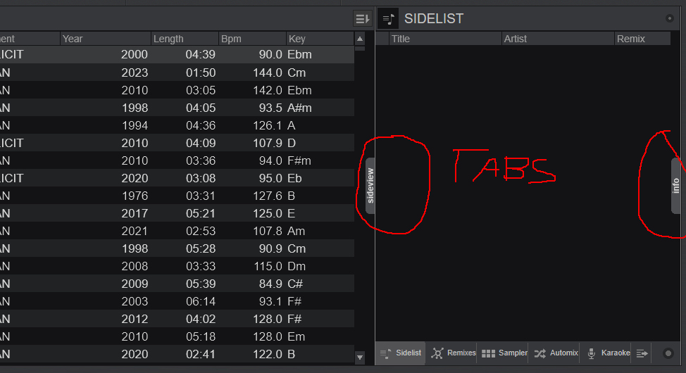

Thanks DJDAD. Just wanted to see if it would possibly have a way to help me understand how to create my own custom browser without the Info tab that drives me nuts lol

The ability to remove a tab from the browser window. Sometimes my backup DJ gets confused when loading set lists and adds deletes tags in the info window. Just would make life easier for me if that tab wasn't there. Like I said previously, In the touch skin I was able to modify the browser to not show that tab at all. However in the other skins I can't see where to do it.

No need to create a complete custom browser. The <browser> element can take toolbar="" sideview="" folders="" infos="" as Yes (default) /No. https://www.virtualdj.com/wiki/Skin%20Browser.html
So try adding infos="no" to your Skin <browser> elements ..
<browser infos="no" ... > or even <browser infos="no" sideview="no" ... >
