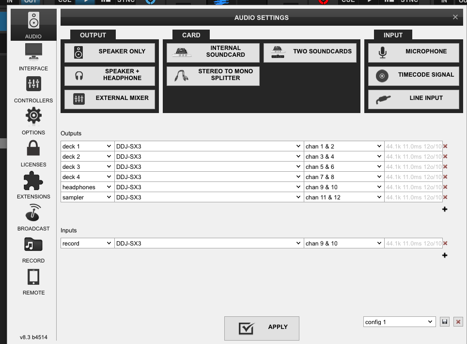

You are definitely doing something wrong, please post a screenshot of your Audio setup
Posted Wed 08 Aug 18 @ 10:19 am
I'm also unable to CUE on the left deck.The Master CUE works for both decks. My audio setup below. And also for some reason the right deck is not allowing me to scratch it only lags the track.
Posted Wed 08 Aug 18 @ 10:40 am
