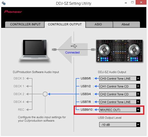

Also, from the DDJ-SZ Utility (should be at [Applications] > [Pioneer] > [DDJ-SZ] > [DDJ-SZ Settings Utility].) , make sure the USB 9,10 is set to MIX (REC OUT) as per the image below

Finally got it to record but the audio is about one third, How do I raise the volume on my recording. My master and faders are on yellow,
Posted Fri 20 Apr 18 @ 1:43 pm
ok I got everything sorted out, Thank you for your patience.
Posted Fri 20 Apr 18 @ 1:50 pm
What do you have in VDJ Settings for zerodb ? "default" or a lower value ?
Also, from the DDJ-SZ Utilities, the default output level is -10db. See if there is a value closer to 0.
