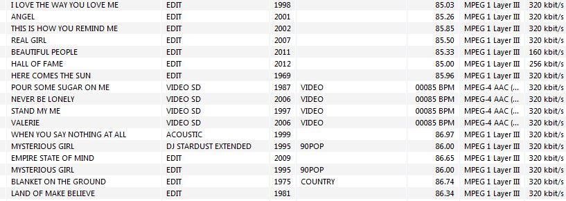

No, I just use MP3 and MP4. Haven't dabbled with Apple stuff in a long time as I hate them with a passion. Especially iTunes.
As you can see here the MP3 files are correct but the MP4 are not.
Posted Mon 19 Feb 18 @ 9:31 pm
BPM in MP4 tags is indeed limited to rounded numbers, this is a limitation of the metadata specs of mp4.

The issue is, in the BPM field when read by MP3Tag, it actually reads exactly like this: 00125 BPM while VDJ would read it as, 124.998. I don't have a problem with the rounding or lack of decimal. I'm simply trying to understand why it read the actual letters BPM in the ID3 tag, or metadata field.
Posted Tue 20 Feb 18 @ 7:10 pm
You'd have to check with MP3Tag. The tempo field in mp4 metadata is just a single byte, so both the 0's at the start and the 'bpm' text are added by MP3Tag.
Posted Tue 20 Feb 18 @ 7:51 pm

I wonder why MP3Tag only adds 00 and BPM to MP4 and m4a (as far as I know)?
I've emailed the dev. He hasn't responded.
