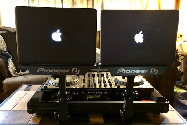

Testing both soundcards, one is main laptop. one is backup and for requests.
Posted Thu 12 Apr 18 @ 10:30 pm
^ I wonder if anyone will be able to spot a DJ behind those laptops lol
Posted Thu 12 Apr 18 @ 10:37 pm

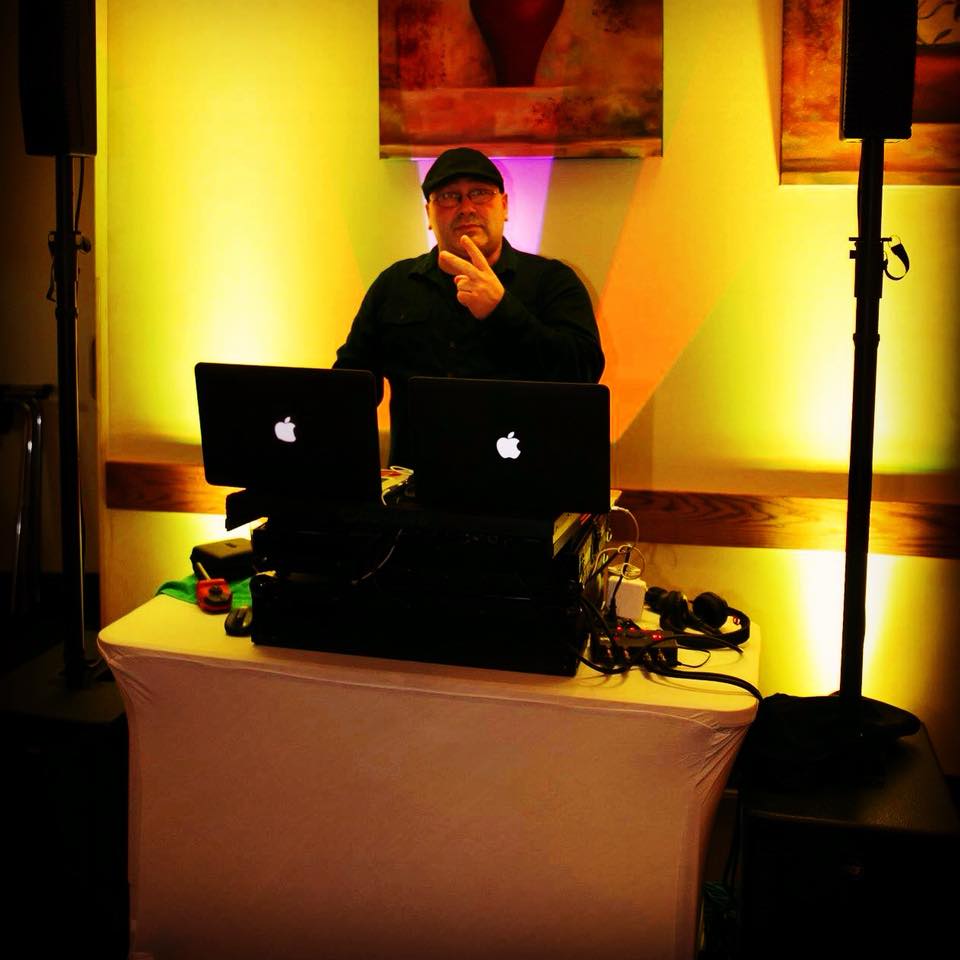

LOL heres my old set up, i'm not THAT short

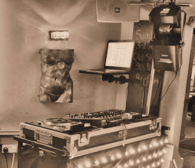

I prefer to keep any laptop(s) to one side...

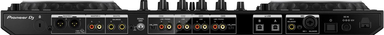

Typically I have two controller/audio interfaces, two laptops, a mixer, main amp, & sub amp.
1. There is obviously no dedicated sub out, so what would you guys do if you were trying to eliminate my extra mixer?
2. How seamless is the USB 1 and USB 2 handoff if I have a laptop freeze up?
Thanks!!
Chris
Posted Sun 15 Apr 18 @ 5:33 pm
So.........your mixer (make/model?) has a dedicated sub out, that you're using to feed your sub amp separately to your main amp?
If that's the case then you need to purchase an active crossover to go between the output of your controller and the amps (e.g. DBX 234 or 223XS).
The crossover will do the splitting of signals into low/high or low/mid/high to feed each amp separately.
Posted Sun 15 Apr 18 @ 6:06 pm
if you do not normally use the booth output you can feed your subs with that as well but groovins suggestion is probably a better choice.
Posted Sun 15 Apr 18 @ 6:18 pm
wickedmix wrote :
ifeed your subs with that
But that would be a full range signal, so unless his amp has got filters for that kind of stuff, he'll need a crossover.
Maybe there's low pass filters in the subs, but as he hasn't said what they are...
Posted Sun 15 Apr 18 @ 6:28 pm
Actually Pioneer made it easier on DDJ-1000 than all other controllers that support this (SZ, SZ2, RZ, RZX)
You just flip the SOURCE switcher on top of the mixer section to the USB port you wish to control.
Also with the DDJ-1000 way of DUAL USB you CAN mix right side and left side on the same PC while still using 2 computers at the same time.
In other words you can use DECK1 & DECK2 on USB A and DECK3 & DECK4 on USB B.
This was not possible before as the USB buttons on previous models would assign the hole "side" of the controller to one USB port.
In short, USB assignment on DDJ-1000 is "per deck" while on previous models it was "per side"
Posted Mon 16 Apr 18 @ 7:19 am
