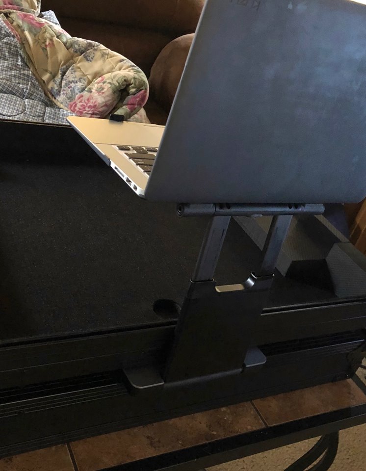

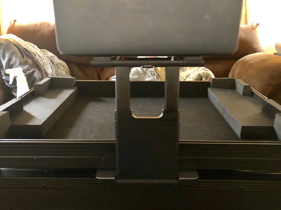

I have the Swan Flightcase.
The main differences that I can see is the space underneath the DDJ-1000 and the Swan case has a better handle for carrying.
It doesn't mention in the description that there is space under the DDJ-1000 of 45mm or 1 3/4inches, plenty of storage for wires.

Thank you mate. I thought it was the same despite the handle issue.
I guess I prefer yours :-)
