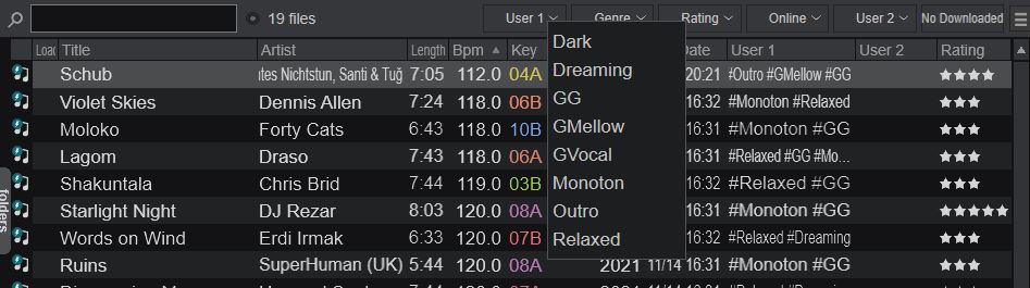

Hey Folks,
yes, the field User1 and 'User 1' was handled the same in old versions of VDJ. Now it makes a difference and you should use 'User 1'.
Btw: In my newest version of the script, I prefix the tag with a hash: `#Funky #Groovy #Relaxed`.
Like this you can take advantage of the new native tag-system of VDJ: You set the Tags very fast using the pads and can use features like dynamic filters as a feature out of the box of VDJ:
Maybe VDJ could add verbs in script to add or remove a tag 😎
Here's the snippet of my current script:
get_browsed_song 'User 1' & param_contains '#GG' ? nothing : get_browsed_song 'User 1' & param_equal '' ? browsed_song 'User 1' '#GG' : get_browsed_song 'User 1' & param_add ' #GG' & browsed_song 'User 1'
Cheers Jochen
Cheers Jochen
