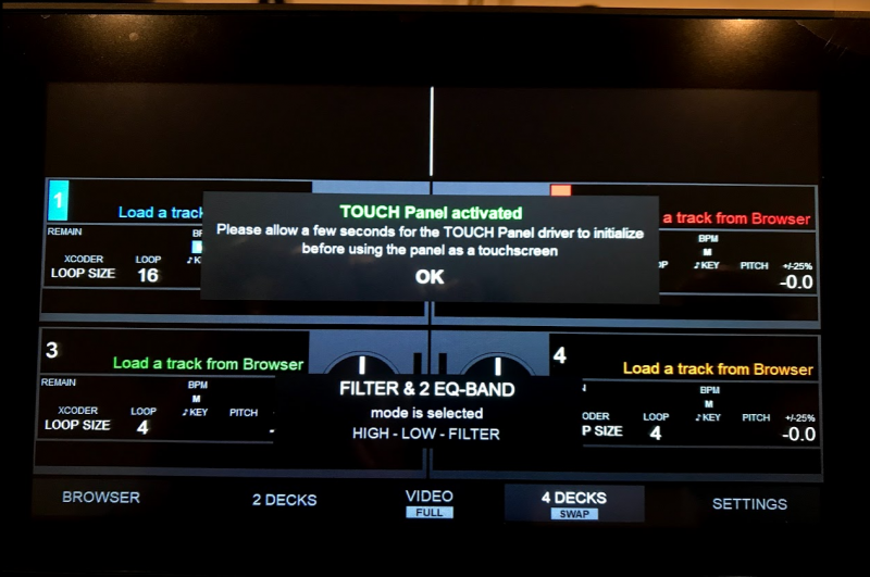

1) In 80 percent of all cases I also get the Reloop Touch Screen message
"Touch Panel activated""please allow a few seconds for the TOUCH Panel driver to initialize before using the panel as a touch screen". (see attachment)

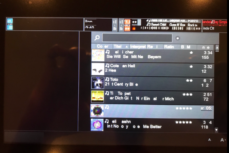

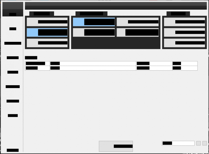

3) If I want to go to the options in Virtual DJ, the graphic is not displayed correctly in the Options window. (see attachment)

Here are the screenshots with error messages and graphic problems.

Here are the Screenshots

Wurlitzer.sk wrote :
thats normal. The Touch driver may take a few seconds/minutes to initialize, so the message says you may need to wait a bit before the touch feature is available. The message goes away automatically (or if u press OK), but the time before the touch feature is available may be more (or less) compared to the message duration.1) In 80 percent of all cases I also get the Reloop Touch Screen message
This is what troubles me mostly, and could be the cause of all your issues. Does this appear the same way regardless if the Reloop Touch is connected or not ? What is the graphics card of your computer ?
Try to update its drivers.

djdad wrote :
That’s a problem. This message stays on on screen. I can’t press ok. Doesn’t respond.
Drivers a up to date. It’s a NVIDIA quattro k1000m graphics card. It only appears, if the Reloop touch is connected.
Sometimes, it does work. I try some settings for Display scale, but no chance.

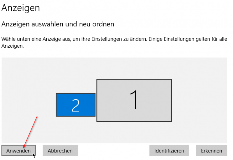

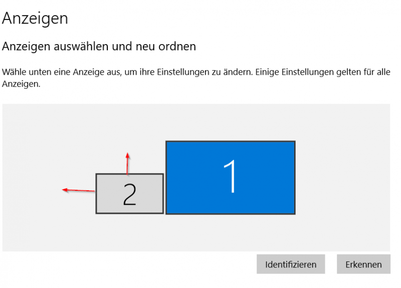

Okay, here's a quick update:
I get the touchscreen to work when I switch back to the Windows Properties screen and simply rearrange the two screens again and click "Apply". It doesn't matter where I move the icons. It is only important that a change takes place and I can click "Apply".
I have also completely deactivated the NVIDIA K1000M (NVIDIA Optimism Graphics) in the Bios and tested it with the internal Intel HD graphics card. It doesn't make any difference. Problems occur with both graphics cards.
There is still a problem:
The virtual display keyboard always appears on the primary screen.
Something else:
The headphone output is extremely noisy. Too bad!
Please keep me informed.
I need a working controller by December 9th. Otherwise I have to return the controller and choose another solution. That would be a pity.....
Thank you for your support!
DJ Wurlitzer
Move screen icon
Click to apply
After that, this display disappears.
Only when the display disappears does the touch screen work properly. I cannot confirm by clicking OK. However, you can see that the touchscreen registers finger inputs in general.
I feel a bit like a beta tester. :-(

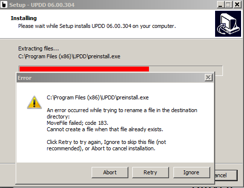

I can't fully install the touch driver. I get this error:
Please note: I'm on Win7, which looking at the Reloop page is not officially supported
I can Ignore this error, and a couple of other like it, and get everything up and running, including the screen
But the screen then has no touch support

Yeah, well, I asked that beforehand, and it should work on WIn7 also, even though it isn't listed on the Reloop homepage
Posted Wed 29 Nov 17 @ 4:13 pm
Regarding installation on Windows 7, the issue forwarded to Reloop for further investigation. We will reply here as soon as we have a solution,
Posted Wed 29 Nov 17 @ 6:29 pm
I think you can cancel that - I'm sorry
The first laptop I tested on was my work laptop
I re-tested on my home laptop, which also runs Win7, and it didn't have the problem
I'm thinking it must be some security feature on the work laptop that causes it
