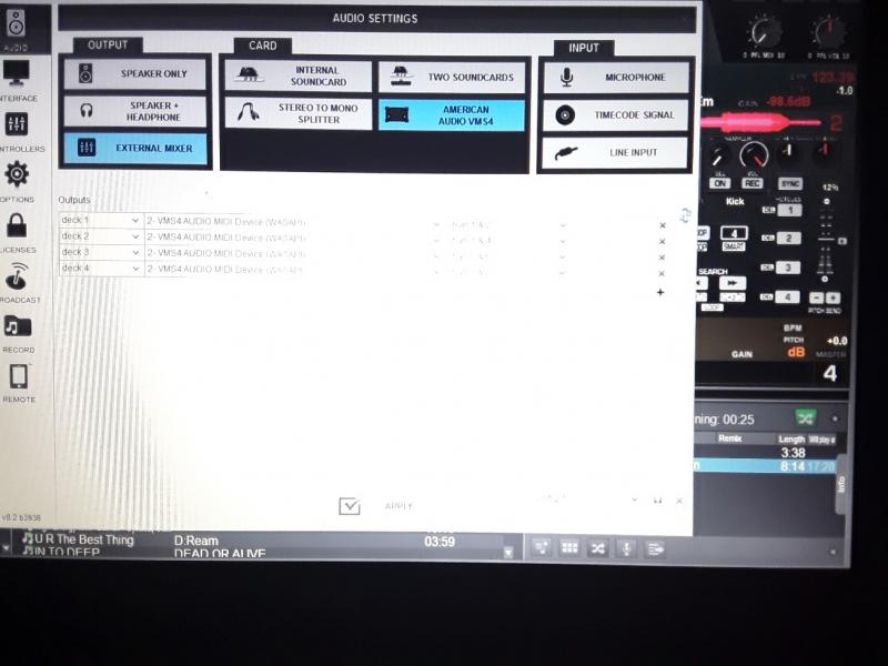

Ok, that part seems fine. Go into settings and make sure its like in this pic.
This is how mine is set up and it all works perfectly.

Mine is the same as your settings apart from the Deck box, yours in blank, mine has Automatic 1,2,3,4
Could this be related to the problem, when I click on the arrow next to the box, there isn't an option to leave it blank.

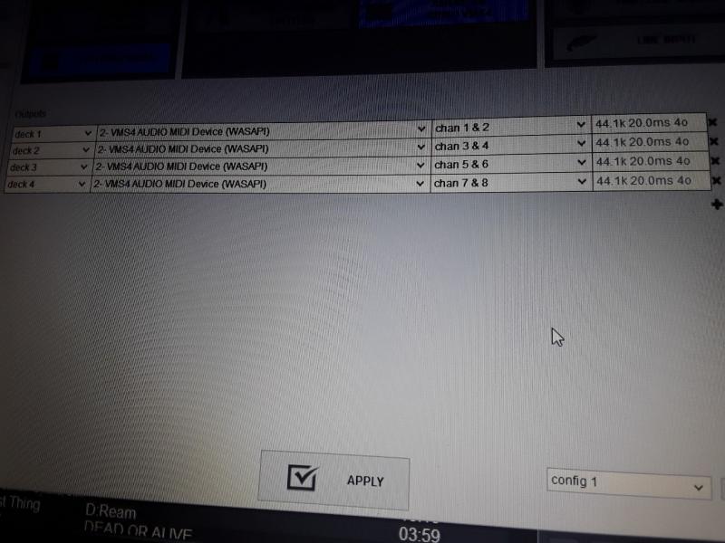

You need to install the ASIO drivers.
From your audio setup screenshot, it seems that you are using the WASAPI drivers. The ASIO drivers will also provide you the ability to check the EQ mode of your unit as per the manual http://www.virtualdj.com/manuals/hardware/americanaudio/vms4/advanced/eqmode.html
