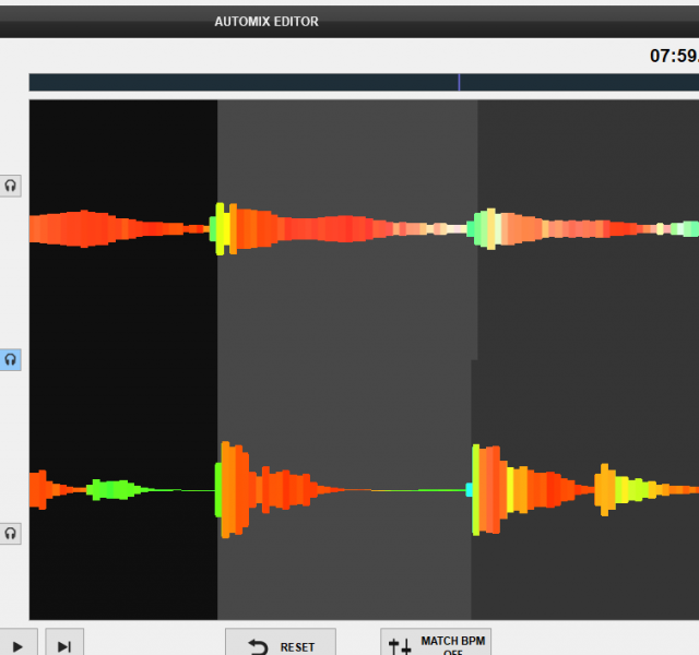

Is it possible to implement more zoom in automix editor? I would really love to be able to zoom infinite, or at least so much that I can clearly see the beats...

Please implement infinite zoom level.... it is really annoying that I can zoom in more than enough with only 20min of tracks listed in the automix list, but if I want to have an hour or more in the list it only zoom an certain amount from the total lenght which means it is impossible to set up a longer mix perfectly with visible beats. Is this difficult to implement or is there a reason that it is not implemented?

well the automix editor already zooms in way in just like the rest of the editors maybe that's why the lack of a reply?
the problem i see is the waves are not as detailed as the other editors but i would think that is probably a bug.

Sorry, didn't have time to check it before.
There is indeed a bug that makes the maximum zoom level smaller when the total mix is longer, this will be fixed.
The detail of the waveforms is indeed lower in the automix editor, this is because it would take too much memory to load the detailed waveform of long mixes.

Ah, thanks :D that was all I needed to know, now I can sleep again :P hehehe

b3978 - Thanks a lot, works perfectly now.

As a workaround for the automix editor detail, you can load the tracks that you are currently working on to the decks so that the waveform is available in full resolution.

Thanks for this explanation. Very interesting to learn. And seems it is enough to load a track in any deck to get detailed waveform.
