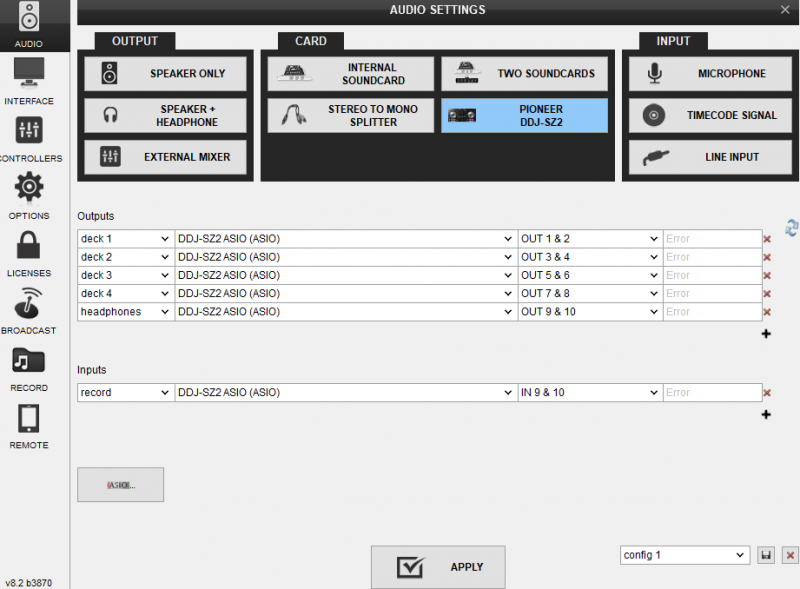

@hh73, please post here a screenshot of your Audio setup of VirtualDJ
It should be like this http://www.virtualdj.com/manuals/hardware/pioneer/ddjsz2/installation/index.html
Also read this page http://www.virtualdj.com/manuals/hardware/pioneer/ddjsz2/troubleshooting.html

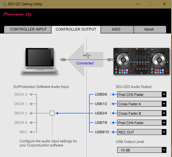

yeah did two things. i had on the first physical deck a 1200 plugged in set to phono. for now its back to usb. then went into the ddj-sz control panel and changed to -10db. it was set to -19db. no wonder i couldnt hear anything.
now it is 80 percent working right. i also removed the other two decks since i wont use them. here is a pic of my pios output setting. looks a little strange. but its working better. and does the setting in vdj where in config it says something about splitcue.. would that work with this unit even though there is no split cue switch
Posted Mon 11 Sep 17 @ 7:00 pm
what does post channel 4 fader mean. there arent any other logical options.
