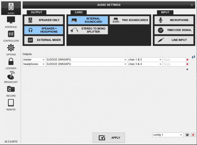

So I received my DJ2GO2. Followed the 'instructions" and can not figure out what I missed as I can not get it to work with v8.2 b3870. Sound is passing through it, but that's about it. I have Virtual DJ Pro Infinity. It says there is no need to unlock the controller. Maybe I have not had enough coffee yet, what am I missing. See screen shots. Thank you in advance for your time and assistance.

You have manually selected the DJ2GO, but the DJ2GO2 is probably not auto-detected.
Numark DJ2GO2 was recently added, so you will need to use the EarlyAccess Build (currently 3936). To get the EarlyAccess Build, enable the setting EarlyAccessUpdates from VirtualDJ Settings and re-open

Thank you! Up and running now, looking at the tweaks

Just got my DJ2GO2 today and had trouble getting it to work. Enabled EarlyAccessUpdates as recommended by djdad and now it works like a champ. Thanks for the tip!
