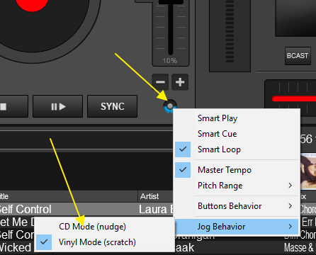

I just got it and would like to use the jog wheels while the track is playing to be able to fast-forward or rewind to find a cue point.
Could someone let me know what mapping do I need to modify for this to happen? The setting is on dj Pro 2 ´out of the box´, so I am certain that it can be achieved.

vidanes wrote :
2) When the song is playing, dj Pro allows it to fast-forward or rewind at a similar pace that when the song is paused. Whereas in VDJ it seems to slightly speed or slow the song rather slightly.
Any idea how to get the same behaviour when the song is playing or is paused?
Leave the action for the JOG to jogwheel.
Select Vinyl/CD mode from the Deck options to get one or the other behavior
You can have a custom/controller button mapped as ... vinyl_mode .. to toggle
Posted Sat 17 Feb 18 @ 5:02 am

That did it! Thank you so much DJdad!

N1ckYDControlleristMember since 2016
Hi. I have just bought the Numark DJ2GO2. I find in the recommended Serato DJ Lite, I can use the two large round wheels to 'slow' the tracks ever so slightly when they are out of sync. I dont know if this is called 'nudge' or whatever, but it works really well in Serato. My problem is that I want to use Virtual DJ8. In VDJ8, the wheels only seem to scratch further up and down, plus it cuts the music out, whereas in Serato it keeps playing just being nudged every so slightly. Can someone help me to map or adjust something in VDJ8 so that I can do this similar, 'slowing' or 'nudging'. Thanks for your help.
Posted Mon 19 Mar 18 @ 11:19 am
Read the post two above yours!
Posted Mon 19 Mar 18 @ 11:32 am
