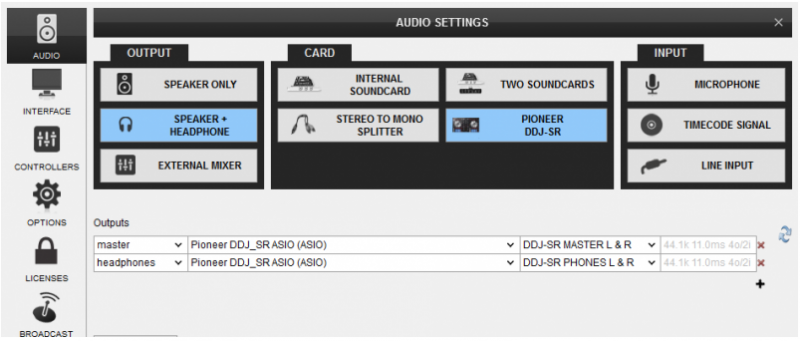

Your audio settings should look like this:
Then of course your speakers and headphones must be connected to the DDJ-SR - not to the laptop
If the button with "Pioneer DDJ-SR" on it isn't on your screen, you probably have a driver issue
In that case you need to get the ASIO driver from the Pioneer website, install that first, and have you laptop recognize the DDJ-SR before starting VDJ

thanks for replies , yes my settings come up the same as in the pic sent , headphones are plugged into controller , volume up on both headphones mix & master level , controllers connected to amp & speakers , musics playing fine but no sound still whatsoever out of headphones , i dont know if this helps but i am a licence holder too , any more help will be greatly appreciated
