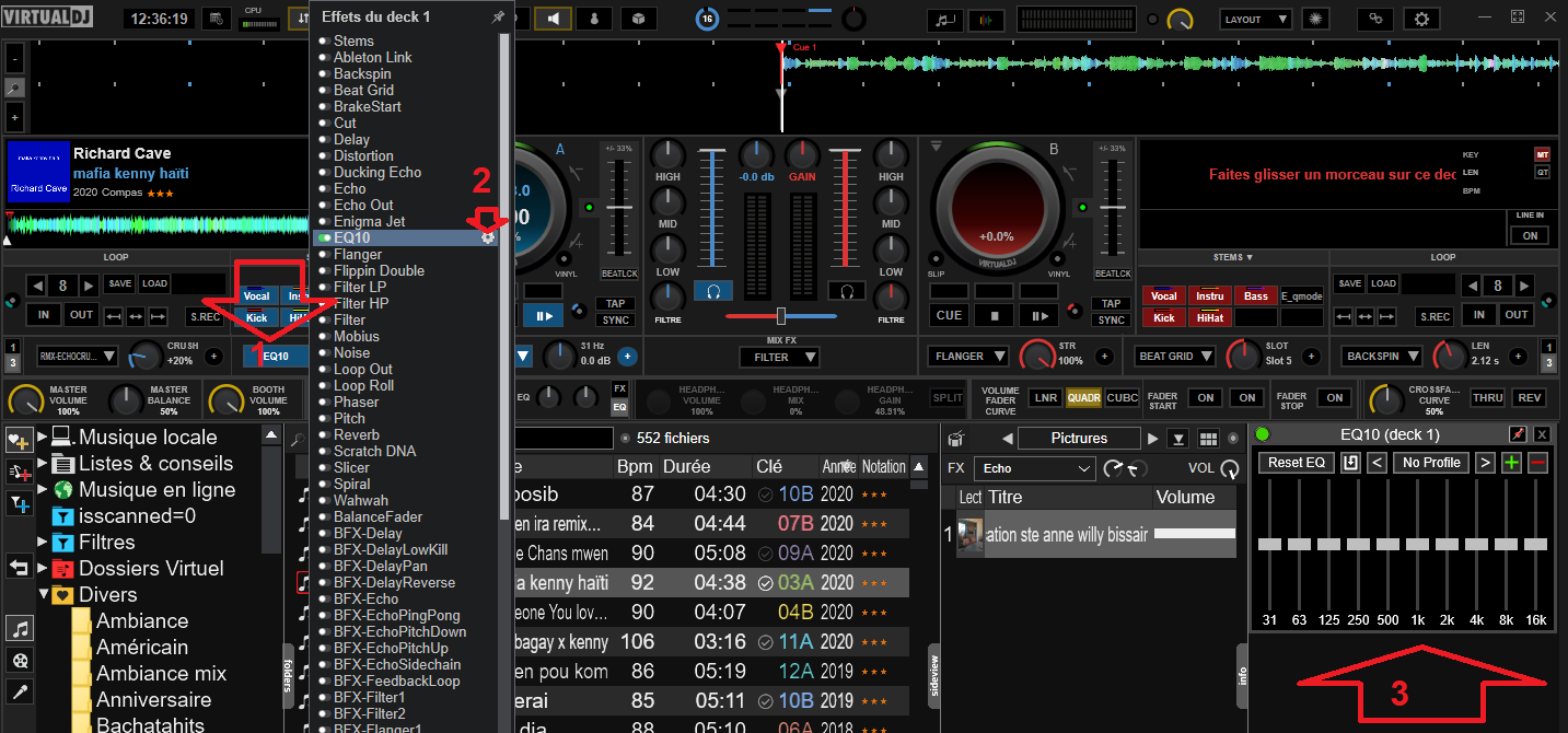

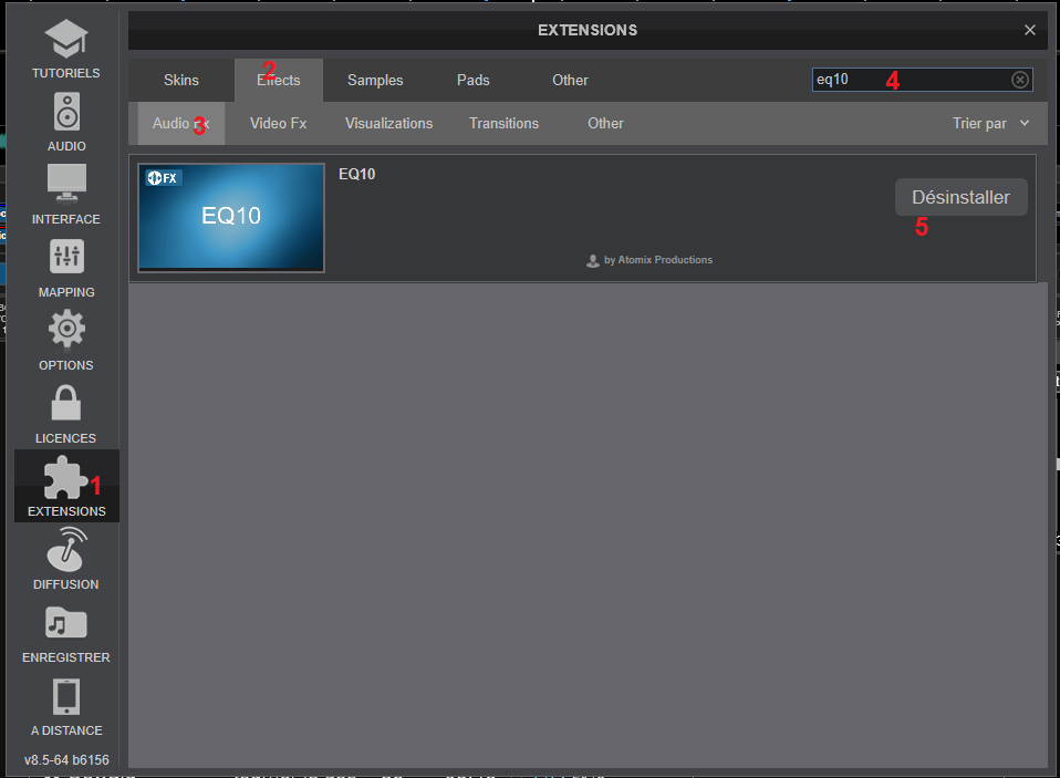

hello
To download Eq10
To download Eq10
Posted Thu 12 Nov 20 @ 4:41 pm
user19727540 wrote :
hello guys!
im trying to find a way to reduce the bass on my software. is there an equalizer that i can use or download as a free user? ive searched the add-ons and extensions, and didnt find one.
In addition to the EQ plugin you find in Extensions (see above), you can also use VST effects with VirtualDJ....
And literally 100s of such available. . From free, to high end pro producer kind..
Posted Thu 12 Nov 20 @ 5:21 pm
