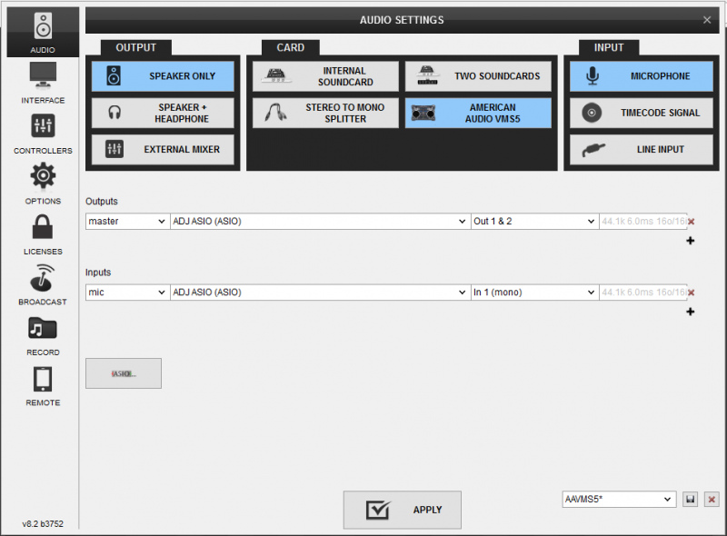

Hi, Ive been radio broadcasting for a long time, but have previously connected to the broadcast server through a third party program on a seperate computer to my VDJ laptop.
Ive purchased a American Audio VMS5.0 and have moved up to VDJ8.2.
i can connect to the broadcast server from VDJ, and send the VDJ audio with no issue, however, the Mic (which is input via the VMS5.0) does not send to broadcast.
If i listen to the MIx output in my headphones, the Mic is there in the mix.
what am i doing wrong??!

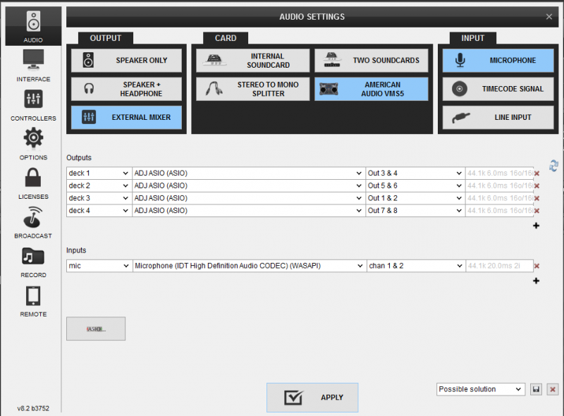

Like this? - tghis shows a signal at my IDT soundcard coming from VDJ. will Broadcast pick this up as the place to recieve its signal?
Posted Wed 28 Jun 17 @ 5:51 pm
Sorry, my bad... with "mic" in the original audio setup (deck 1,2,3,4) VDJ will record/broadcast the Microphone connected to the sound card you pointed, but not your mix, or at least not correctly.
So better try the one you see in the Manual (link i gave you above) without any "mic" line and Mic connected to VMS5.
BTW, the "record" line is under the "Inputs" lines, just like your "mic". The pic in the manual is from an older Build where outputs and inputs were in the same block.
