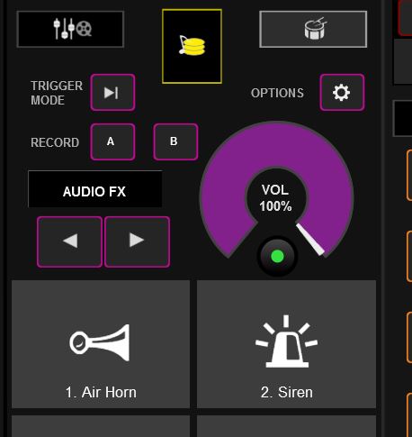

Hi, i'm not sure if this is setup incorrectly - the volume button circled in red, has the script above it (as does the volume button on deck A). When turn up the sample volume, knobs on both decks move simultaneously as they should - however, it doesn't control any of the sample volumes. I have to use the horizontal slider volume adjacent to the sample to affect volume level.
Any help would be appreciated, thx

Hi, thx for the reply. I'm using multi-touchscreen skin by djDad, and the sample volume on this skin doesn't work for me. Any suggestions? I don't see a way to add a script to the volume control.

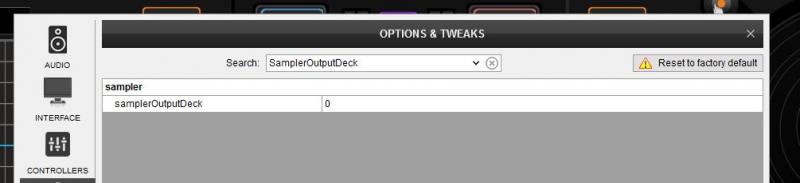

So the samples play and you get their sound in your speakers but u dont have volume control via the skin Volume knob ?
What is your audio setup and what value does the setting SamplerOutputDeck have ?
Posted Fri 30 Jun 17 @ 1:56 am
Hi, Sampleroutputdeck = 0
Yes, the samples play (At full volume), but no volume control using the round slider knob.
Posted Sat 01 Jul 17 @ 4:29 am

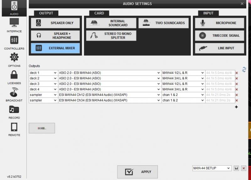

I played around with it, and got it working with this config for the pci Maya 44 card.

Why have you duplicated the sampler output? Surely it only needs one pair of channels.
Posted Sat 01 Jul 17 @ 6:54 am
I assume you are using some kind of external analog DJ mixer. In that case, if you get rid of both the "sampler" lines, the Sampler should be routed to both of your mixer channels and the software sampler volume knob should work... no ?
