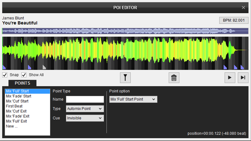

Anyone notice that Fade Start and Exit points have gone missing in the new builds? Had a ton set and they appear to be gone.
Pretty much all other set points appear to still be there.

Like MixFadeStart and MixFadeExit?
Mine appears to still be there (when I click "show all")
I'm on the newest public build (b3734)

3760 here. Lots, if not all, of previously Fade Start and Fade Exits have been erased.

Are the poi erased, or just moved?
It looks like the fade points will indeed be recalculated even when set manually, this will be fixed in next build.
In the meantime you can go back to the current stable build until the update is available
