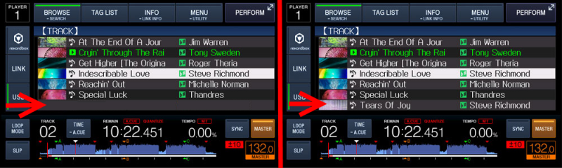

If I'm correct this build fixed the issue that the browser on the XDJ 1000 screen has a empty / unused rule on the bottom.
I still have this issue with the XDJ-700 browser and build 3731.

build 3752 and still having this issue with my XDJ 700's

On your mapper change "DATA_BROWSER" key from
get_pioneer_display 'browser'
to
get_pioneer_display 'browser' 1001
Let me know if it works OK and if it solves your issue.
If it works OK I will update the native XDJ-700 mapper
PS: I had the impression that XDJ-700 screen was smaller than XDJ-1000 and that it didn't contain any extra blank lines. Sorry!

Thanks!
It does work when I add the 1001.
thank you for putting this solution in a next build.

I use the xdj 700's and I'm not sure what browser issue you are referring to. Could you explain what problem you was having please? Thanks.

toppadon wrote :
"......I'm not sure what browser issue you are referring to."
It's not really an issue. It's just some extra used space on the browser :)
Left side how your browser looks now (on the XDJ700), Right side how the browser looks with the fix. (PS: Picture is from the internet but just to show what I mean)
