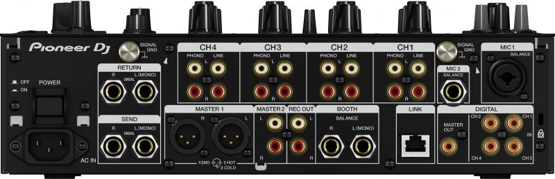

Every mixer has 1/4 jack inputs ? I'm afraid not!
Even though ONE mixer would be enough to say otherwise, here we go:
Pioneer DJM-250:
Numark M101:
Behringer DDM4000:
Ecler NUO4:
Rane TTM57MKII:
Rane MP2015:
And finally:
Pioneer DJM-900NXS2:
Mind you that the RETURN 1/4 jack inputs are to be used in conjunction with the effect chain of the mixer (in other words you need to configure the FX Send/Return chain properly for them to work as "inputs" and mix their audio with the master bus).

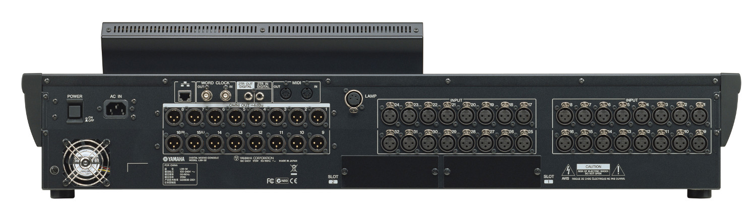

Finally let's assume a Mixing console instead of a Dj Mixer:
Yamaha LS9:
Pioneer DJM-250:
Numark M101:
Behringer DDM4000:
Ecler NUO4:
Rane TTM57MKII:
Rane MP2015:
And finally:
Yamaha LS9:
Posted Tue 20 Jun 17 @ 1:23 pm

Here we go again..I don't think the Phantom lives in the real world. Look few venues will have a Yamaha LS9 - 16 https://www.thomann.de/gb/yamaha_ls_916.htm?glp=1&gclid=EAIaIQobChMIxoj_3uDO1AIVnqntCh12VQnTEAQYAiABEgJ8XvD_BwE. They cost over £4000.
This is the type of thing you're often likely to encounter when using a venue pa system, maybe just a little bit bigger http://www.ebay.co.uk/itm/Yamaha-MG124CX-12-channel-mixer-very-good-condition-little-used-/302332160140?hash=item466466a88c:g:~JgAAOSwcgNZLCsE
This is real world.
Venues don't like spending money..hm most are very frugal.
This is real world.
Posted Wed 21 Jun 17 @ 10:57 am
Yes, I live in outer space! :)
That being said, this mixing console is just an EXAMPLE to prove that NOT ALL mixing consoles / mixers have 1/4 Jack inputs.
The most common input plug on DJ Mixers is RCA, and on Mixing Consoles is XLR, or XLR and 1/4 jack combo.
