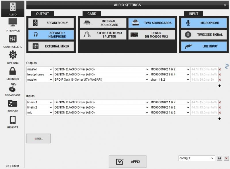

Hi all, I've been trying to figure out what is the trouble with the mic and virtual dj.
Here is the case: I try the mic on input 2 and it works with the internal soundcard on the denon.
When I try to record anything with both the internal recorder or VoxengoRecorder the mic don't get recorded.
Mic sound don't work on the external asus soundcard either. Only out of the denon internal soundcard.
It seems that the mic on the controller is only connected to the internal sound processor of the denon, and don't
affect what's going on in virtual dj's mic input, even though it is listed in mic input on the sound setup.
How can I fix this issue? Do I have to use another input?
The mic is a cheap qtx dm11 (not condensator mic)
Maybe this have been discussed before, sorry if i suck in searching...

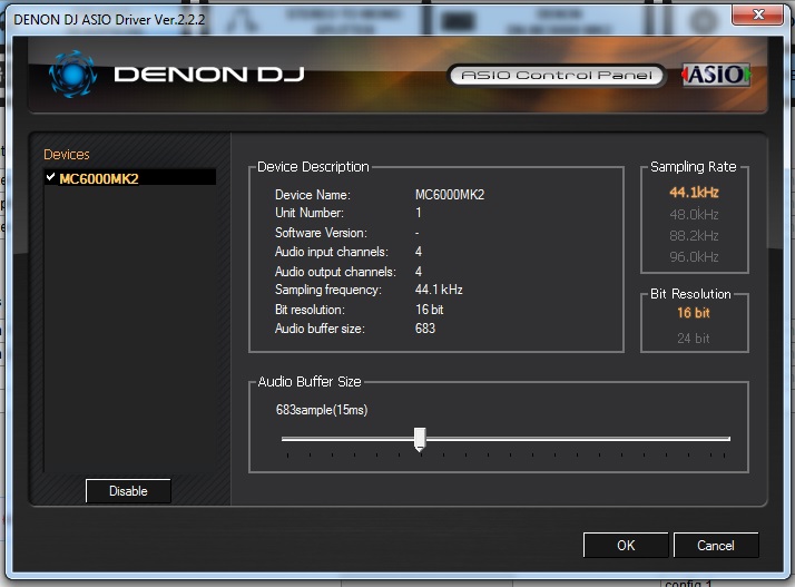

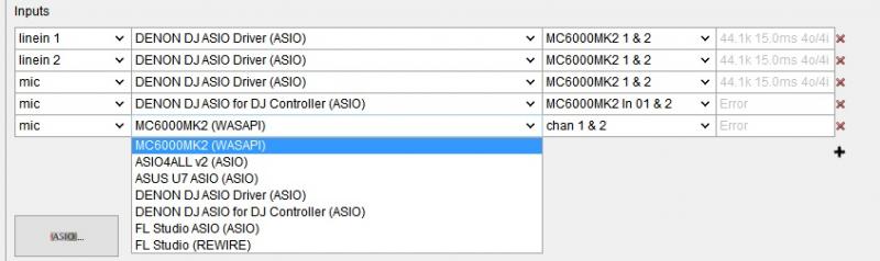

Here is the asio setup btw...
The only option that works is the first mic input, all other options give Error, asio failed to create sound buffer.
I have tried to use other asio drivers, but 2.22 is the only that works at all.
Posted Sat 06 May 17 @ 7:58 am
