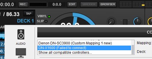

1. [See picture attached below]. My vdj and setup is working right now, but the virtual dj program says 'failed to connect' in the vdj controller settings. This is a complete contradiction and proves an issue with the virtual dj program.

1. So with the DN-X1600 selected in the controllers section, when you move faders on the mixer, you see these signals coming in?

1. Yes, the midi function light is always triggered on the mixer regardless if vdj is properly working. It should be known that recently the mixer has been connecting without the 'failed to connect' error, but I think it's still something to look into. It does happen randomly and it makes no sense why. I also don't have the mixer mapped to vdj. The only mappings I have are the midi page buttons (the 6 buttons going down vertical next to the effect spot).
