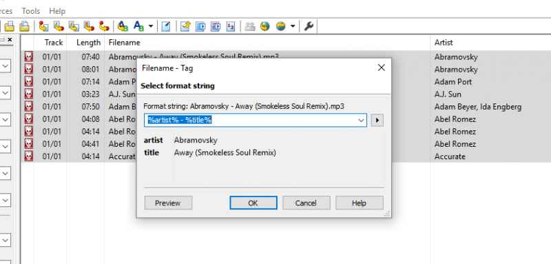

not inside virtual DJ but a free program like mp3tag has the ability to select parts of the file name and insert those into the tags in a batch manner afterwards you can just do the reload tags :-)
http://www.mp3tag.de/en/download.html
here is a screen grab of the feature

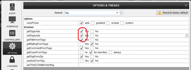

Type a * (star character) in the Search box. This should display all tracks of your Library. Then click/select one and use CTRL+A to select all, right-click perform the batch operation.
Also you may need to change the setting gettitlefromTags to No (from VDJ Settings-->OPTIONS tab)

OK, you can select all the tracks by selecting one of them and then pressing "ctrl & A" on your keyboard. This should highlight all of the tracks. Then right click and go to tag editor. then click the dot and tell it to get info from the file name.

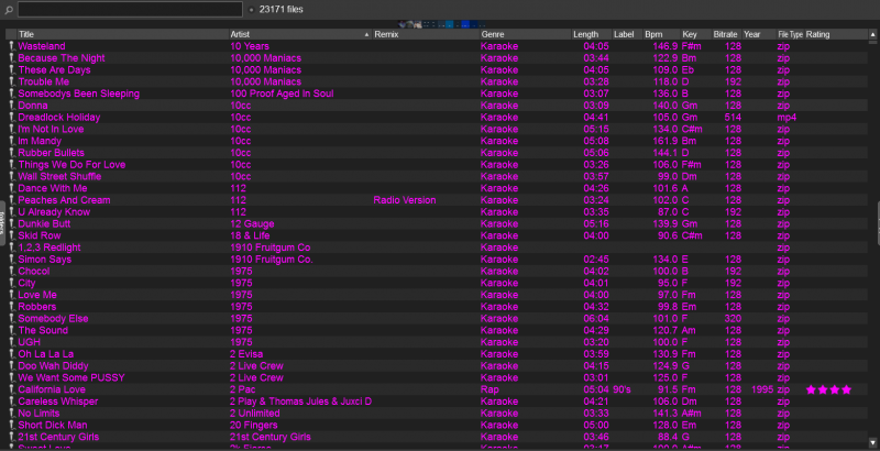

Normally the two files are zipped together and VDJ then just reads the name of the zip file, which can then be renamed in VDJ. They will work without being zipped, but does give you the issue you are mentioning, that is not being able to rename the file within VDJ. The name of the zip file doesnt need to be the same as the name of the files within it, but the names of the file within it still need to be the same, if that makes sense. So you could just zip them all, then change within VDJ. You can do it by batch within VDJ too
Posted Fri 19 May 17 @ 10:17 pm
Here are mine, most of them are zip files. I have them purple just so i know what they are when doing a normal gig.
