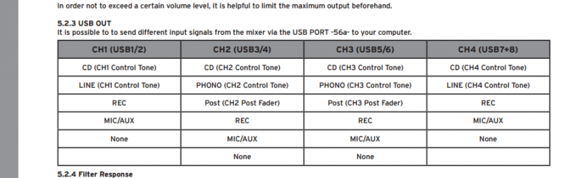

          The Reloop RMX80 doesnt have a USB Audio interface, so cant be used to record your mixing via a DJ software. The USB at the rear seems to be used only to update the firmware of the mixer as per the manual at page 20.
The RMX90 DVS provides what you want though.
I got this from the manual
So, it appears that you can use any Chans pair as a Record Input, but you need to sacrifice one of them. Once you set it up with a REC Input, you can add this input to VirtualDJ Audio setup as .. E.g.
record ... Reloop ... chans 1,2 (or any other you have chosen).
The channel you will use as REC cannot be used for Timecodes or any other.
BTW, we expect a sample unit from Reloop to provide official support soon.
Other mixers that provide recording of the Master Output (inc Effects) via the USB Audio Interface are DJM900/NXS/SRT, Rane mixers, DJM-S9
