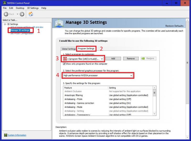

If you updated your NVIDIA drivers you may need to add VirtualDJ.exe to the "NVIDIA control panel" (right click your desktop to get to NVIDIA control panel). Then select the NVIDIA card as the default video card for VDJ. I don't have my laptop here for screen shots, but Google is your friend...

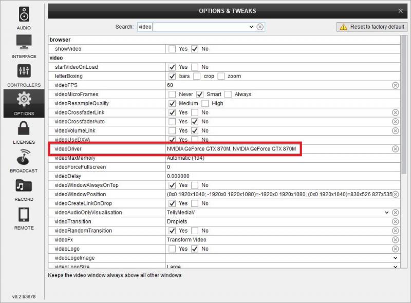

I am running VDJ 8.2 b3678 (newest current public release) & NVIDIA 381.65 (newest current public release). Plus every public version on VDJ and NVIDIA up to this point with no issue. We may not have the same setup, but do have the 870m card in my laptop. I would not be so quick to blame the NVIDIA driver or VDJ. I am even running the latest Win 10 Creators update (build 15063) which is why I opened this post, I was hoping nobody has found an issue with all the latest updates yet (Win 10, VDJ & NVIDIA).

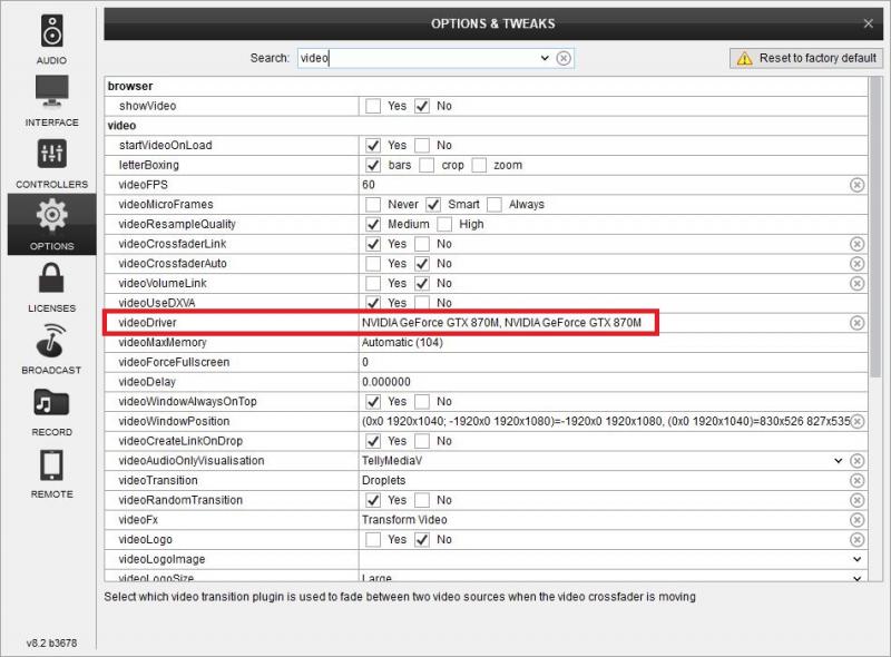

Adion, I have seen VDJ list 2 cards under video driver. I am not sure how you could select a different one though. When NVIDIA set under control panel (OP see below) and I connect an external monitor, I just get a second NVIDIA entry like you see here. Intel should only show up if you do not have NVIDIA forced.
OP, here is the NVIDIA control panel I was talking about. You may very well be technically savvy enough to know this. But I always question the continual "Yeah, I already tried that" response, when I don't see any specific descriptions of what you have tried or screen shots. Sorry to beat a dead horse, but like Adion said, I have no idea how you can select different cards for the same program.

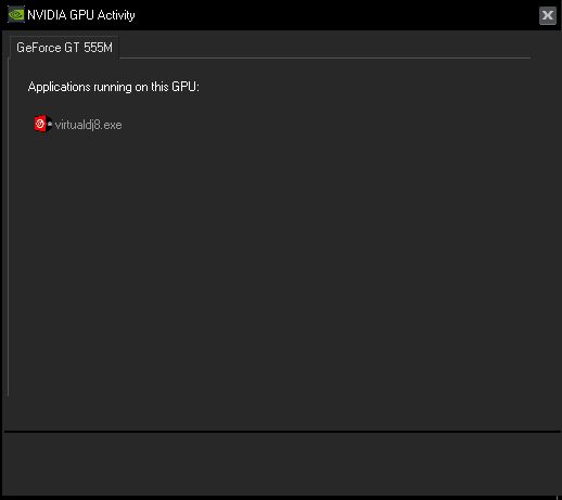

Adion. Nvidia has a program (Nvidia GPU Activity) that tells you what is running on the nvidia graphics card. When working correctly you normally see 2 programs of virtualdj running within it. one for virtualdj program and other for the video output. Serato also works exactly the same way when you activate Video output. The Video window runs as a 2nd program. Problem is you can't launch them from desktop. They are launched from within the program so you cant force the High Performance. Also when I right click on the 2nd output video window it is listing my video card as Intel. I think i'll take the advice of completely uninstalling the video drivers and start over.

Vdj obly opens one the device one time when videoforcefullscreen is set to 0, so it is normal for vdj to be listed only once
So the problem you are having is a low framerate on the video output but not on the skin?

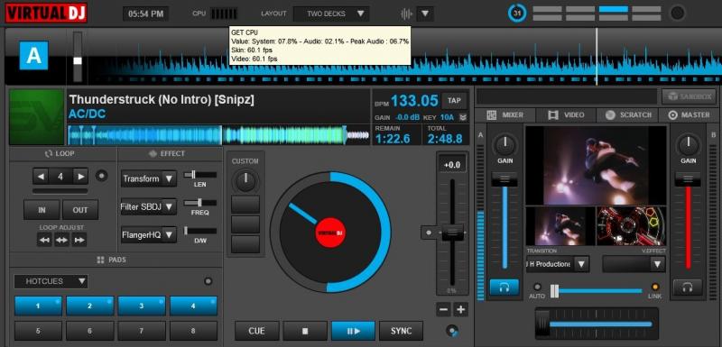

If you hover the mouse over the cpu usage indicator it should show a tool tip with the fps of both. What does that say?
Videodriver in options just lists all the drivers currently active, it's not a choice and not an indication of which is used by vdj.

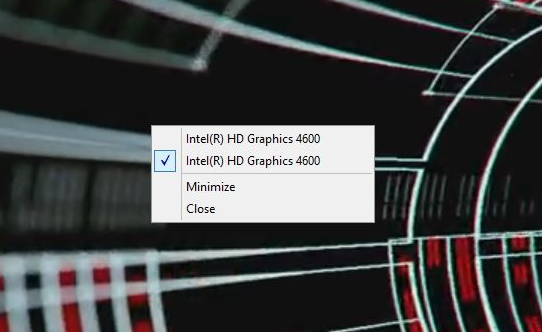

Without ever using that NVIDIA tool. I will say that the competition's video plugin is actually a separate EXE. I know that because I have to force NVIDIA on both every time I update the NVIDIA drivers because I always do a clean install. But I would actually expect two programs from the other guys.
Here is what I can say, you may have some merit to right clicking on your second screen window in VDJ. I also see Intel 4600 on my 2nd screen in VDJ when I right click on it.
But that same session still indicates NVIDIA for both under VDJ settings.

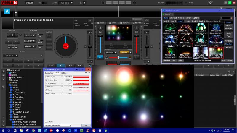

When I use GPU Z, VDJ does seem to have my Intel card at about 9%. Which promptly drops to 0-1% when I close VDJ (Nothing else running). So it does appear the VDJ is using my Intel card too.
I will also say that I still get that stupid diagonal screen tearing still in VDJ. This was addressed in the Win 10 Creators update that I just installed. With Resolume running and Vsync enabled, I don't get tearing anymore. So that is also enough for me to say that VDJ is ignoring the NVIDIA Vsync on somehow. Which could lend further evidence to VDJ possibly using the Intel card and not the NVIDIA one for my second screen.

Here is the FPS for the OP to compare to. I have super smooth playback, even right now. Looks small so the Skin and Video are 60.1 FPS. Music video playing in deck 1 and AOV set to Telly Media playing on empty deck 2.

DHoude wrote :
Note that this menu only shows the monitors name, or when no name is provided the name of the adapter the monitor is connected to.
In the case of combined Intel/nVidia graphics, the monitors outputs are always connected to the Intel graphics. The work can be done by the nVidia GPU, but the output is then sent back through the Intel to the screen.

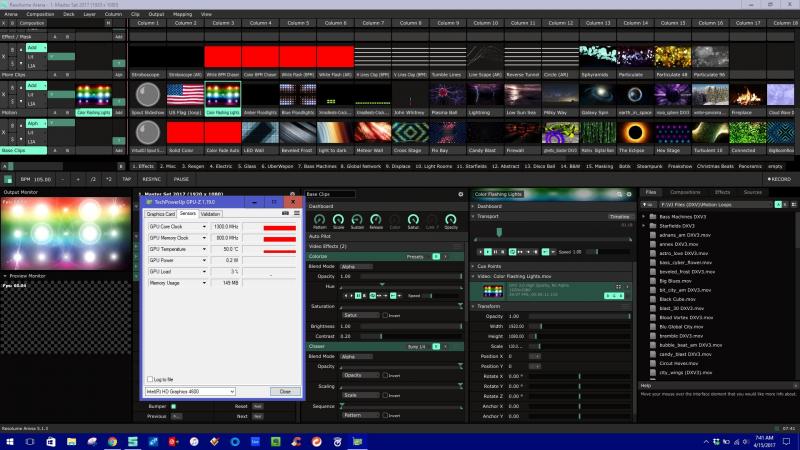

Here is Resolume Arena forced the same way in NVIDIA. Same settings and even the same clip. GPU Z says Resolume is using the Intel at 3%. Normally 0-1% without any program open.
Here is VDJ running the same clip, with GPU Z saying Intel is utilized at 15%. Intel was 10-13% right when I open it (video not even active yet)
So it is pretty hard to deny that VDJ is using Intel more than another live video performance app. Resolume is capped at 60 FPS because Vsync is enabled. Resolume gets no tearing with the same clip that VDJ tears like no tomorrow on, with the same NVIDIA settings.
Now last week Resolume would also tear with this clip. It was the Win 10 build 15063 update and the new 281.65 NVIDIA drivers that fixed Vsync (last week, and before Vsync did nothing to solve tearing). So why would the same Vsync setting and updates not fix VDJ? Also why does VDJ seem to use 10% more GPU on the Intel chip? It appears to me like VDJ may be using Intel by looking at GPU Z results and the fact that it still screen tears (screen shots don't capture the diagonal tear, but it was tearing when I took this).

So here is what I see. First, I found "videoForceFullScreen" = 1 does fix it. But you have to close VDJ totally and restart VDJ. It is not enough to close the video output inside VDJ, set to 1 and start playing video again. So here are those results:
"videoForceFullScreen" = 1 & "videoUseDXVA" = yes (default), then restart VDJ, diagonal screen tearing is gone
"videoForceFullScreen" = 0 (default) & "videoUseDXVA" = yes (default), then restart VDJ, I get the diagonal screen tearing
"videoForceFullScreen" = 0 (default) & "videoUseDXVA" = no, then restart VDJ, diagonal screen tearing is gone
Personally I choose Fullcreen on and DXVA (hardware acceleration) on. That seems like the most ideal to me. Despite the Full screen bugs from the past.

2: DXVA off
3: videoMaxMemory 1536
The videoMaxMemory said "Automatic (128)". Since I have a 2GB video card, I set it for 3/4 of the 2GB.
The diagonal tearing hasn't appeared in roughly 30-45 minutes of watching videos. I get a little bit of stuttering when using the text feature. Changing DXVA to "on" may fix this.
Hope this helps.
Here's how I fixed the problem:
1: activated Nvidia driver (as instructed by DHoude's post)
2: DXVA off
Hope this helps.
Posted Tue 02 May 17 @ 10:37 am
