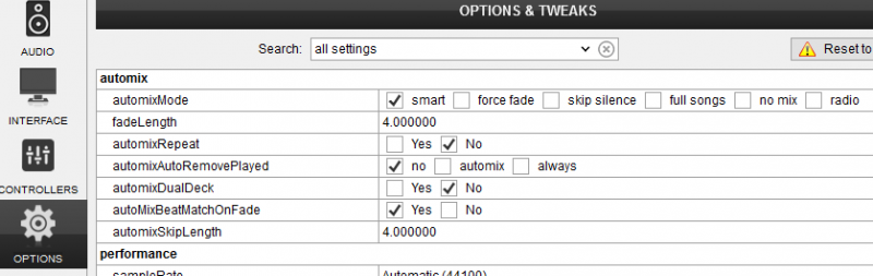

have you tried adjusting these settings pictured here
specifically fadelength

YES. Probably the biggest issue I have is that i cannot smoothly crossfade from the middle of a song and have it start the next song from a cue point like in VDJ7. I used this last night for the first time at a gig and I have never been so embarrassed in my life!

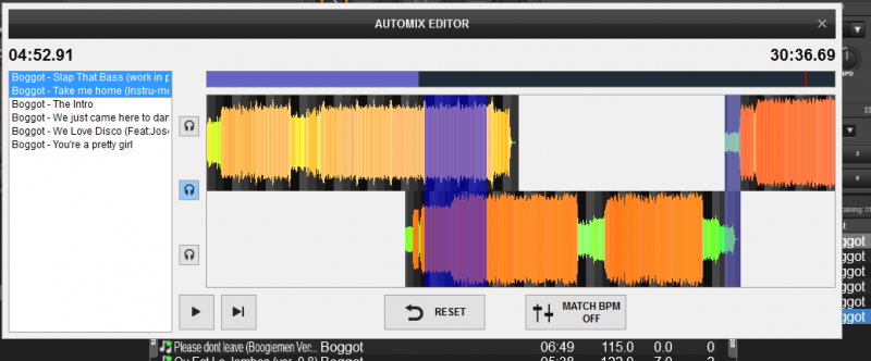

The way you handle automix specifically in VDJ 8 is by using the automix editor. Then you can do just about anything you want in a "timeline mixing" way as shown below. But it's not quick n' dirty like mix_now is in a pinch
