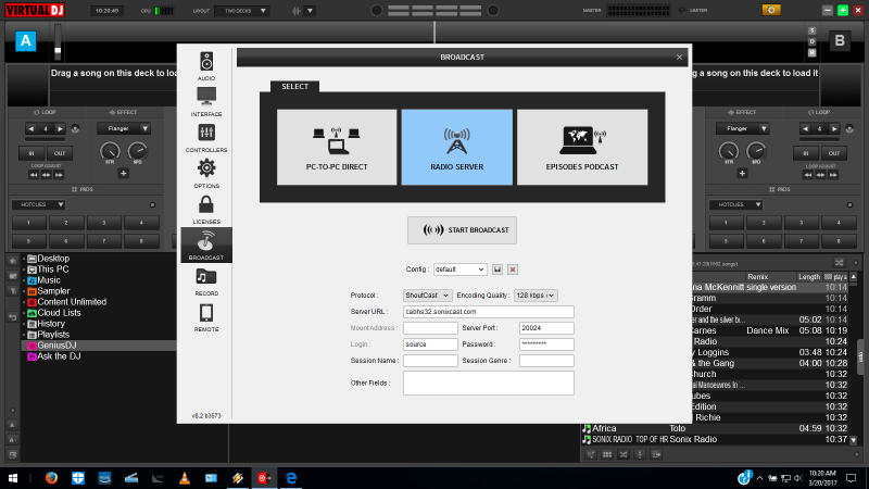

hey guys ive been using vdj to broadcast with for almost 3 ys now just recently I can no longer connect to the radio server where my station is hosted on I get error disconnecting the setting and info is all set and correct I pretty sure vdj still uses shoutcast version 2 the funny thing is I tested winamp with the external shoutcast dsp encoder and I can connect so why cant vdj connect now any help would be greatly appreciated

.png)
Posted Mon 20 Mar 17 @ 3:21 pm
my metadata has always went through no problems I was told by atomix tech support vdj8.2 is shoutcast 1 and 2 compatiable

it is compatible, in fact virtualdjradio.com runs Shoutcast 2 ;)
But, as I mentioned, you might need the password to be set as : password:#streamid ( password colon hashtag streamID) .. .
and I cant see your password in the screenshot above.
That is, IF you do have streamID's.
And regardless, what error reporting do you see in VirtualDJ when you do try connect? (Wrong password? Cant resolve, etc)
Posted Mon 20 Mar 17 @ 3:56 pm
Error disconnecting it tries to connect bit thst what get
