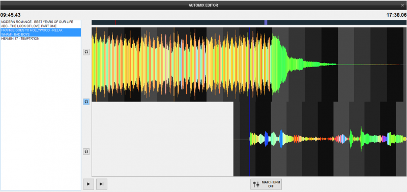

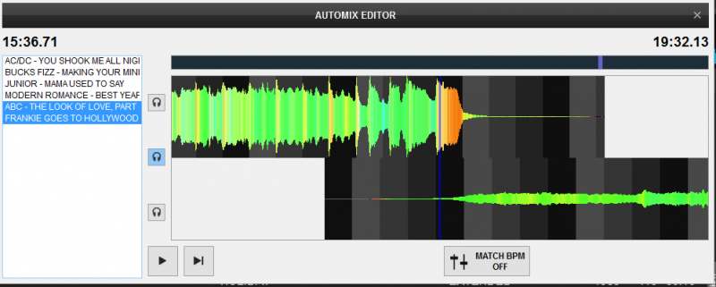

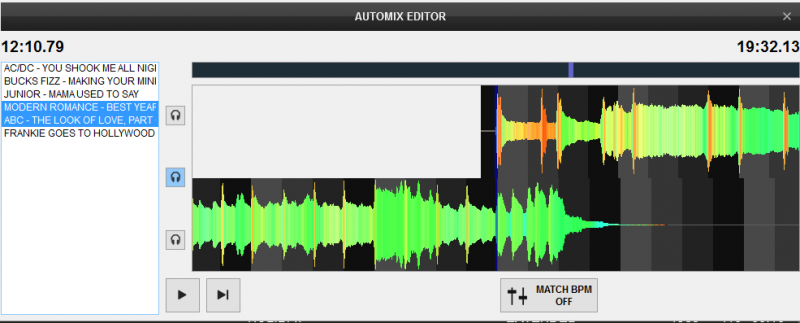

First of all thank you so much for including this. I have done some testing tonight and have the following observations.
I have set the fade to 0 seconds for a sharp transition, would it be possible to have point where the first track ends set at a certain volume level rather than time?
I also noticed that some tracks which stop dead have the last section missing and cut off prematurely per the examples below. Also where a fade is selected it's sometimes missing half a second from the start of the incoming track. Can this be fixed please.
Great effort for the first try, will be interesting to see what others think.

I'm not sure how it is related to the new automix mode if you're using a fade time of 0.
In that case it would be the same as fade (skip silence)
Where are the automix full POI's located in these tracks, and did you try rescanning to make sure they are set automatically?
