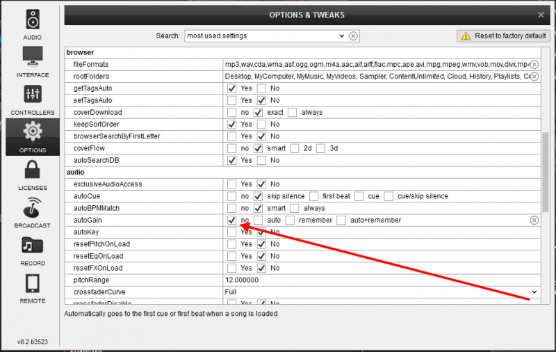

Eventuell hilft ja da auch in der VDJ Software unter optionen ,in das Suchfeld autog eingeben und dann das autogain=auto einschalten ,dann wird alles auf 0dB eingepegelt,und am besten noch zeroDB -3
einstellen ,ob das allerdings auch für die Source Quellen
wie Line in funktioniert weiss ich aber nicht.
mfg,Dirk

Hello,
I would do the opposite: I would switch off the autogain in VirtualDJ 8 Pro
Go in Settings > Options > audio > autoGain: no.

Hi to all,
sorry for my delay in answering, I had an event at friday night - so I tested it just today in the morning.
Autogain NO was the solution of my problem.
Thanks for all the nice advice!

Hello RobRoy,
Yes, it's me.
When playing external sources in VirtualDJ 8, disabling the AutoGain avoids 2 possible issues:
- change of audio input level, as reported by Testinchen,
- a growing noise when nothing is playing on the audio input.
