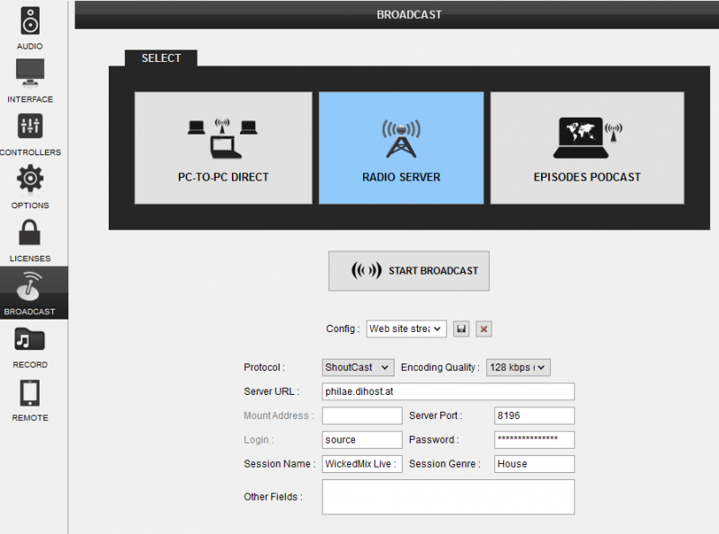

for shoutcast you need these fields filled
Protocol
encoder quality
Server URL
Server Port
Password
see image below
Protocol
encoder quality
Server URL
Server Port
Password
see image below

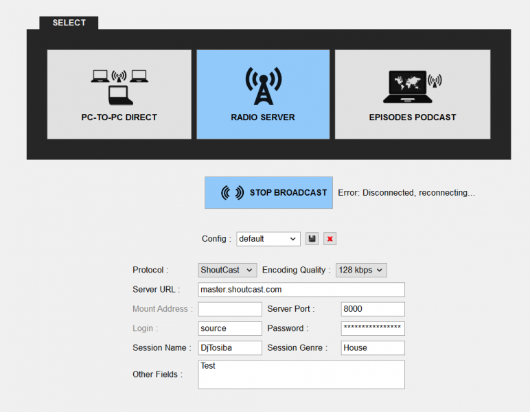

This is what my configuration looks like does it look correct? i see you have another server url.
Posted Mon 26 Dec 16 @ 1:18 pm
umm the server URL ?
you rent a server from shoutcast.com ?
i wasn't aware they did that
the Server URL will be from a server you rent or own....
it looks correct if all the info is correct
Posted Mon 26 Dec 16 @ 1:26 pm
Same with me, figured it out?
Posted Sat 04 Mar 17 @ 10:12 am
Remove the "test" from OTHER field (@Dj_Tosiba)
Shoutcast 2 does not accept the "other" field parameter, and this might be why you can not connect.
And if you also have this @DJDonchino, remove any thing there.
And sounded like you did password + channel (mount) correct, but just incase, it needs to be in this format : password:#streamID (colon and hashtag)
