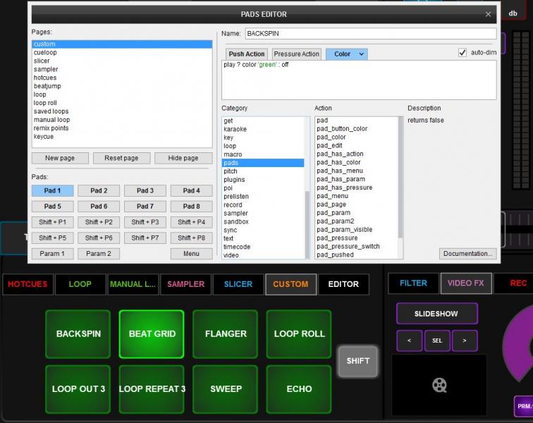

You need to define the Color of the Custom pads from the Pads Editor.
If you just choose a color, the Pad will get this color if the action assigned to the Pad returns true.
The "Color" tab can take vdj script actions as well.
So you can type e.g.
play ? color 'green' : off

Hey DJDad .. I tried the code, play ? color 'green' : off . Yes, it now turns green when selected! Dope!
The script is very simple (see pictures). I just wanted to have some FX's on the pads for quicker access of choosing different ones. The "custom" tab works well for this. Is there a way to change the name of "custom" to another?

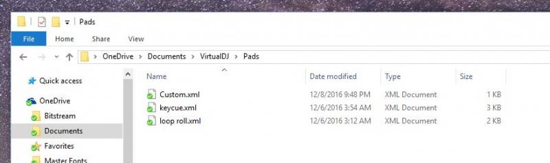

Find the custom.xml in the pads folder and rename the file.

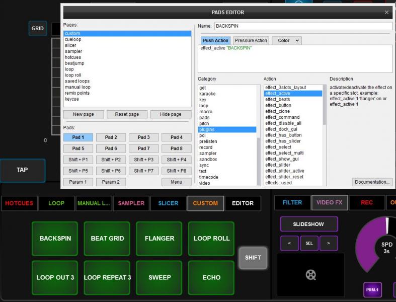

Hi, In the attached picture, is this the "custom.xml" file I can change the name of and it will reflect in the software custom tab?
I copy and pasted [ effect_active "backspin" ? color "yellow" : color "blue" ] into the editor, under the "push button" tab, and then tried under the color tab, but it didn't work for me.

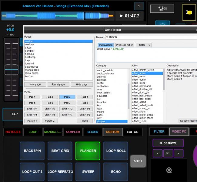

Don't rename the Custom.xml Pad page because you will then have to edit the skin to get the new Pad page instead of the CUSTOM. Don't even bother to open it if you dont know what to change/edit
In the Pad Editor you should have..
Push Button : effect_active "backspin"
Color : For the color, you can simply select a color from the color drop down, which will add the action for you (e.g. color 'red' or color 'green' etc.
This will get you a bright color when the action assigned to the Push button returns true (Backspin is enabled) and a faded color when not.

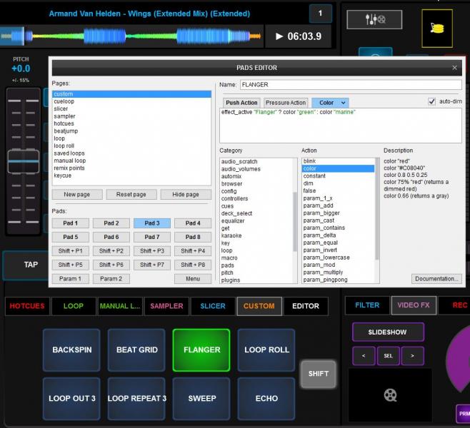

...or you can do something more "complex" like locodog advised..
effect_active "backspin" ? color "red" : color "green" (still in the Color tab)
just hide the new custom pad page that gets created,

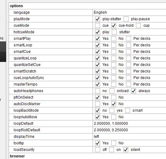

One other quick question regarding the play & cue on the Multi-touch skin. Can the play button be set to "Play-Stutter" and can the Cue be set to CUH (Cue Hold to Play)?

just tested, cuh will work type mode into the options search, you'll see cue mode, you'll see play mode too but as far as I can see it's not working

Thought i'd attach a couple of pictures showing djdads/locodog's programming guidance (as seen above). much love. :)
(Press Custom tab, then press shift, then editor to get into the editor popup).
I just used a subtle colour called "Marine" for the up state, and "green" for the down state" (active). Both colours are in the colour tab.
Substitute the pad's name into the line of coding as shown for "Flanger".
I only put some of my fav effects in the "custom" tab for quick access, but djdad has programmed it that you can use these tabs for pretty much anything I suppose. (He can confirm this). The important thing is, he's left those pads open for us to be creative!

ok real simple to get play stutter working
open the vdj folder [my docs] open the skin folder, unzip the multitouch folder, go into the folder and open the skin xml with a text editor, wordpad/notepad whatever
ctrl+h [find and replace]
find
play_pause
replace with
play_button
there will be 8 instances to change
save the file and close.
while inside the unzipped folder rezip the 3 files there, [preview skin.png skin.xml]
go up one folder level, delete the old zipped version of the skin
open a second window inside the skins folder [so you'll have 2 skin windows open], go into the folder you unzipped and drag the zipped file up one folder.
job done,

Thanks Locodog...yep the play-stutter now works :) The Play-stutter is a nice feature - gives you the option to do a little fancy intro, rather than just play-pause.
You mentioned the CUH is working? On my skin, the CUH isn't working. In the options, the cue-mode is checked on "Cue-hold". When pressing cue for 2 or 3 seconds, it's supposed to continue playing when you release right? Mine just goes back to the cue point when released.

follow the procedure loco mentioned about editing the xml file and
Find : cue_stop
Replace : cue_button

Thanks djdad, yes, the CUH is working nicely.
"EQ Kill" Yes, I missed that Full Kill setting in the options! That does the trick!

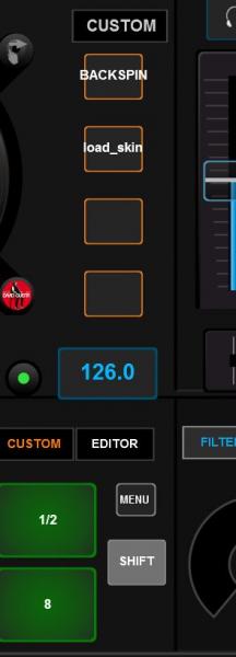

I have another question. I found by accident, 4 custom buttons (Hidden under the waveform window). If I right mouse click a blank button, the "button editor" pops up, but once you assign something to that button, how can you again re-open that button to delete what's there or change it. I tried to right mouse click on a button that has an assignment, but I can't access the "button editor" when it's not "blank" any longer.
See attachment.

well, that's a skin bug :P
Will fix in next update.
EDIT .. fixed , re-download skin.
