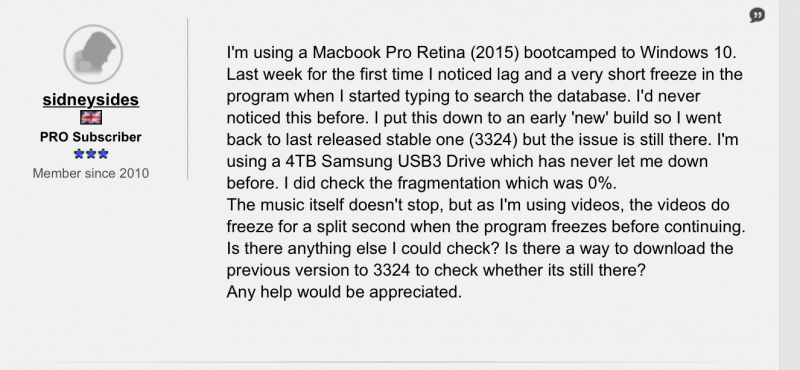

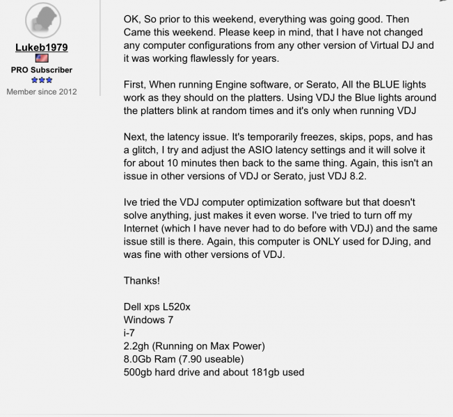

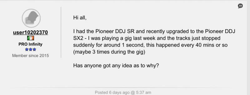

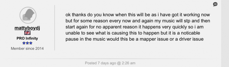

I have copied some of the other posts that are related to the same problem
Posted Fri 26 Aug 16 @ 6:37 am
Posted Fri 26 Aug 16 @ 6:38 am
Posted Fri 26 Aug 16 @ 6:39 am
so can someone PLEASE PLEASE HELP
Posted Fri 26 Aug 16 @ 6:40 am
