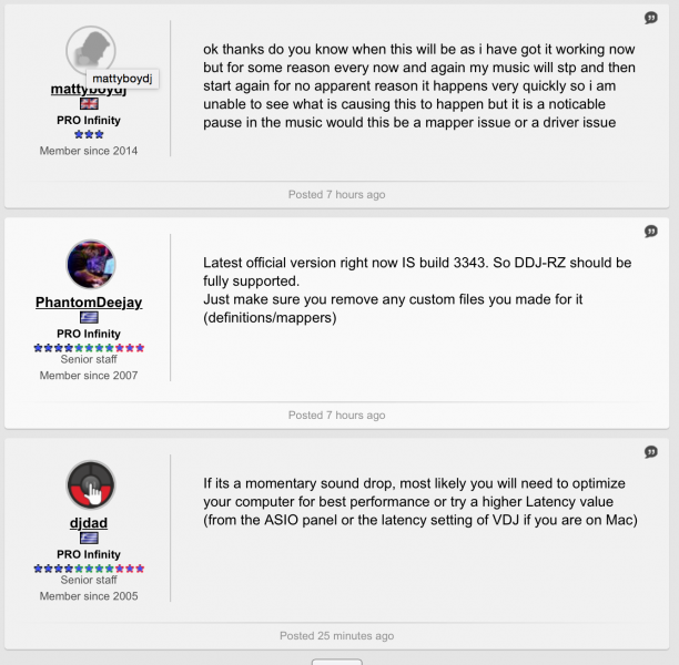

Let me know what you find out they're telling me that we need to change our latency you can look at the post where it says help need help with Pioneer controllers

Just to let you know we are going to try changing the latency on one of our computers tomorrow Will start testing tomorrow afternoon this will take a couple days to check it out we'll let you know as soon as we find out if this works
Also I'll keep checking back here to see if someone help you fix it a different way

I know no one likes to hear this especially not here and I hate to say it but what we have had to do right now until they can fix the problem Is we've had serato up and running on a 2nd computer plugged into the B of the DDJ Sz so if it gets too bad we can just switch over I really don't want to do this but can't lose the gigs and nobody cares that it's my software doing it they just want the music to play right.
