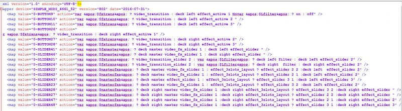

Hello
here is my work... It would be enough to give me one line to program the LED
It should already be able to help...
<?xml version="1.0" encoding="UTF-8"?>
<mapper device="SIMPLE_MIDI_4661_52" version="802" date="2016-07-31">
<map value="0-BUTTON9" action="var '$fxtrans' ? video_transition : deck left effect_active 1 Novar '$Lfilter' ? on : off" />
<map value="0-BUTTON10" action="var '$fxtrans' ? video_transition : deck left effect_active 2 " />
<map value="0-BUTTON11" action="var '$fxtrans' ? video_transition : deck left effect_active 3" />
<map value="0-BUTTON26" action="
var '$fxtrans' ? video_transition : deck right effect_active 1" />
<map value="0-BUTTON27" action="var '$fxtrans' ? video_transition : deck right effect_active 2" />
<map value="0-BUTTON28" action="var '$fxtrans' ? video_transition : deck right effect_active 3" />
<map value="0-SLIDER41" action="var '$fxmaster' ? deck master video_fx_slider 1 : deck left effect_slider " />
<map value="0-SLIDER46" action="var '$fxmaster' ? deck master video_fx_slider 1 : deck right effect_slider " />
<map value="0-SLIDER21" action="var '$fxtrans' ? video_transition_slider 2 : var '$Lfilter' ? deck left filter : deck left effect_slider 2" />
<map value="0-SLIDER26" action="var '$fxtrans' ? video_transition_slider 2 : var '$Lfilter' ? deck right filter : deck right effect_slider 2" />
<map value="0-SLIDER22" action="var '$masterfxa' ? deck master video_fx_slider 1 : effect_3slots_layout ? effect_slider 2 2 :deck left effect_slider 2" />
<map value="0-SLIDER42" action="var '$masterfxa' ? deck master video_fx_slider 1 : effect_3slots_layout ? effect_slider 2 1 :deck left effect_slider 2" />
<map value="0-SLIDER43" action="var '$masterfxb' ? deck master effect_slider 1 : effect_3slots_layout ? effect_slider 3 1 :deck left effect_slider 3" />
<map value="0-SLIDER23" action="var '$masterfxa' ? deck master video_fx_slider 1 : effect_3slots_layout ? effect_slider 3 2 :deck left effect_slider 2" />
<map value="0-SLIDER28" action="var '$masterfxa' ? deck right master video_fx_slider 1 :deck right effect_3slots_layout ? effect_slider 3 2 :deck right effect_slider " />
<map value="0-SLIDER27" action="var '$masterfxa' ? deck right master video_fx_slider 1 :deck right effect_3slots_layout ? effect_slider 2 2 :deck right effect_slider " />
<map value="0-SLIDER47" action="var '$masterfxa' ? deck right master video_fx_slider 1 :deck right effect_3slots_layout ? effect_slider 2 1 :deck right effect_slider 2" />
<map value="0-SLIDER48" action="var '$masterfxa' ? deck right master video_fx_slider 1 :deck right effect_3slots_layout ? effect_slider 3 1 :deck right effect_slider 3" />
</mapper>
LED ????

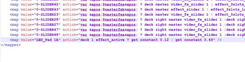

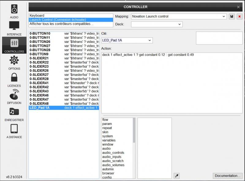

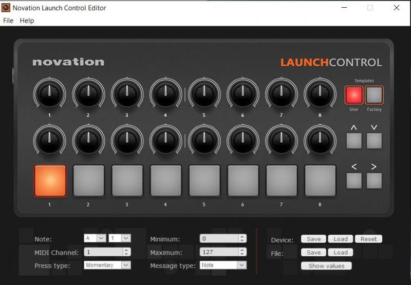

this sets pad 1 to yellow inactive FX when fx active pad 1 is red all this is only for deck 1
<map value="LED_Pad 1A" action="deck 1 effect_active ? get constant 0.12 : get constant 0.49" />
you must use the devices file or this will not work!
Posted Sun 31 Jul 16 @ 2:48 pm
Thank you for your participation
<map value="0-BUTTON9" action="var '$fxtrans' ? video_transition : deck left effect_active 1" /> ???
<map value="LED_Pad 1A" action="deck 1 effect_active ? get constant 0.12 : get constant 0.49" /> ???
Posted Sun 31 Jul 16 @ 4:50 pm

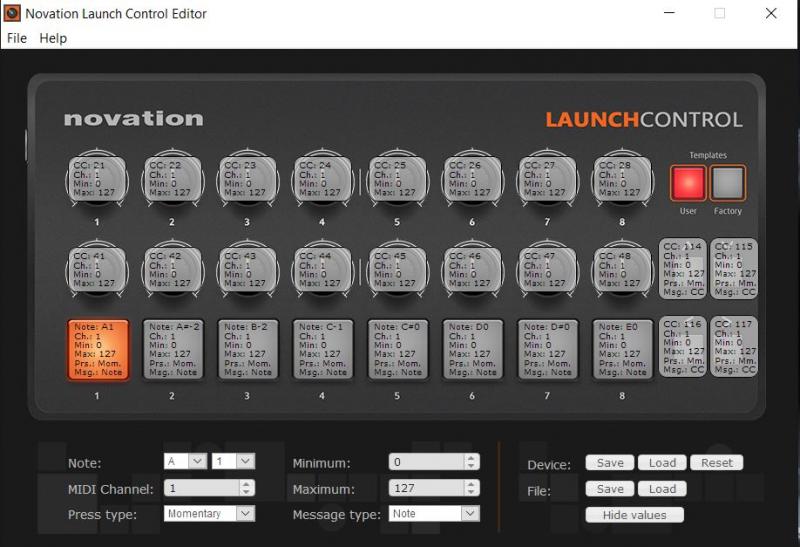

If you want your own mapping file to work with the definition that you downloaded (and use the LEDs too) you will have to ..
Apparently its the first time you are trying to do this, so if you cant follow my instructions, better wait for a few days.
- use the same device name. So not the Simple Midi
but the name="XXXX" you see in the definition.
e.g. if the definition has
<device name="LAUNCHCONTROL" ....
the mapping files has to be ..
<mapper device="LAUNCHCONTROL" - use the names of the keys that you see in the definition
so not <map value="BUTTON-0"
but the names you see in the definition.
e.g. <map value="BUT1"
