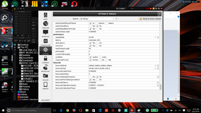

Hi Angel can you do me a favor can you take a picture of yours settings for timecode?
Because I have this issue plus the sensitive of sound but I asked about it and never had answer.

Well, after playing around with tc vinyl I have to say, the sound is indeed instant.
Don't let your ears be fooled by your eyes.
My timecodePitchSliderIgnoreBend is "no" btw...
